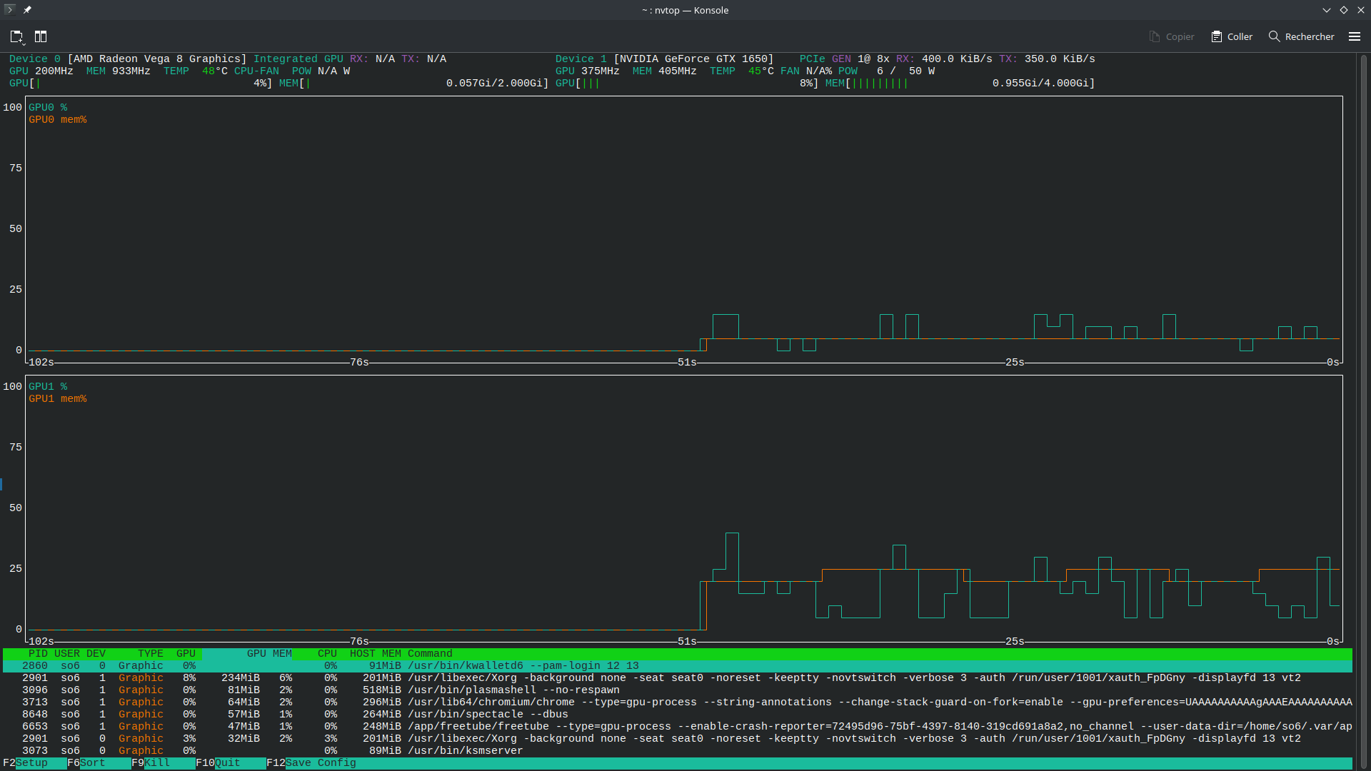

sudo dnf install nvtop

Ill try that out, Maybe it will tell me whats going on with Dayz.
