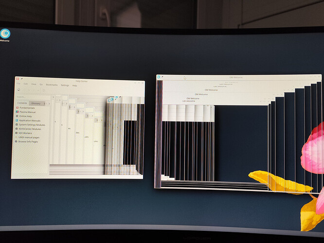

When running OM Lx in LIVE mode with 6.13-desktop-30mv2590 getting it to boot to desktop takes excessively long time and Welcome window is unusable and covered in graphic artifacts as can be seen in one of linked photos. Bug report utility that activated on it’s own also failed to generate automatic report. I tested this on several builds with following results:
B650M D3HP (f33) + Ryzen 7 9800X3D + RX 7800 XT: consistently reproduced the bug
B650M D3HP (f33) + Ryzen 7 9800X3D + RX 5700 XT: consistently reproduced the bug
B650M D3HP (f33) + Ryzen 7 9800X3D (integrated GPU): no bug, much faster booting to live mod
B555M DS3H + Ryzen 7 5800X + RX 7800 XT: no bug
As an experiment I made full install on integrated graphic configuration that had no detectable issues in LIVE mode (B650M D3HP (f33) + Ryzen 7 9800X3D (integrated GPU)). Install completed successfully however after the install I could not open Welcome window at all, either from desktop icon or control panel. Handful of other apps I tested seemed to work fine.
Links to photos:
postimg.cc/gallery/qMjSkGC

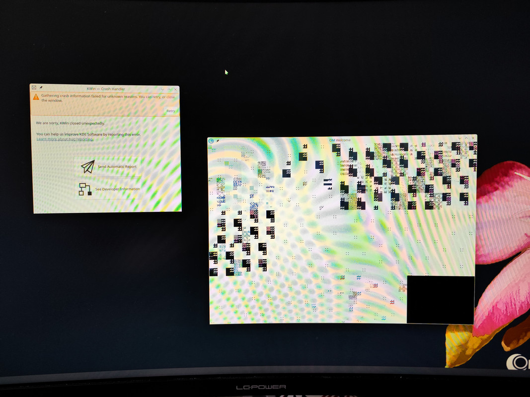

I tested this build in LIVE mode with similar end results.
When monitor was plugged in to DP of discrete graphic card (RX 7800 XT) result was same as with build I tested yesterday, with protracted boot time and Welcome window producing identical graphic glitches. This build had more aps preinstalled so I tested many of them and they seem to work fine with exception of Help Center window that had similar graphical glitches as Welcome window. Images of bugged widows can be seen in link below.

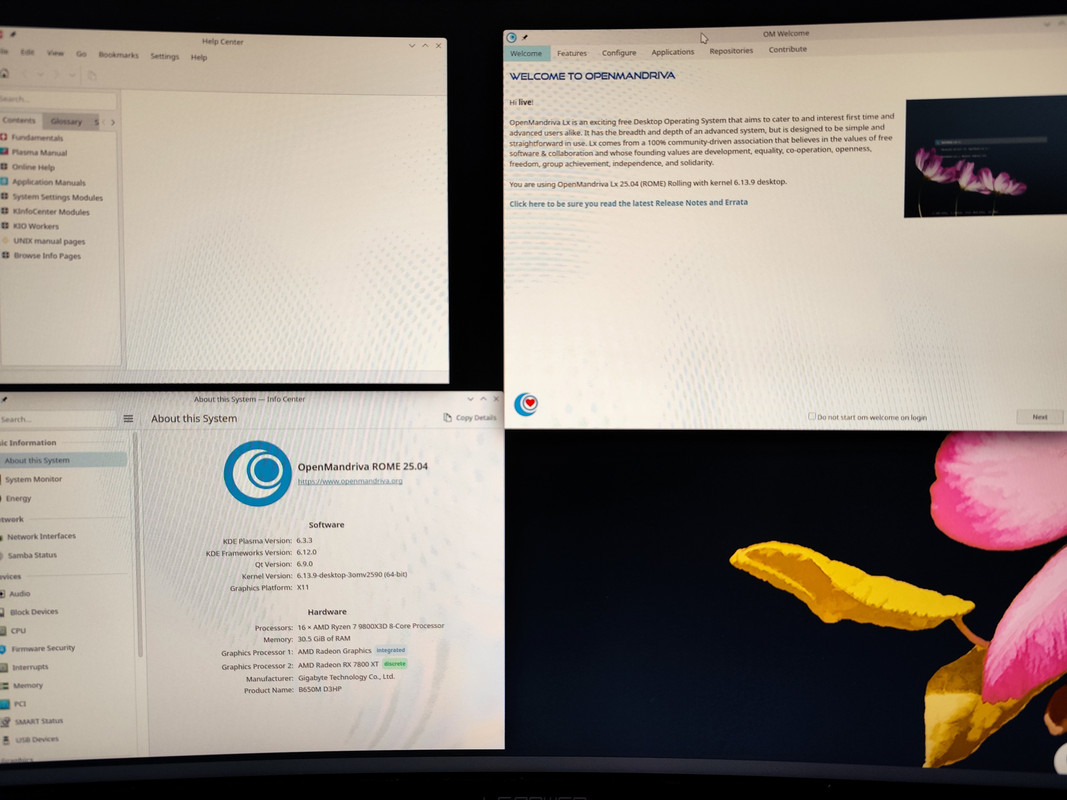

I again also tested new build with monitor plugged in to motherboard DP and therefor running on integrated GPU of 9800X3D. In that case system booted in to LIVE mode super fast and both Welcome and Help Center windows did not show any obvious graphical issues. Image below:

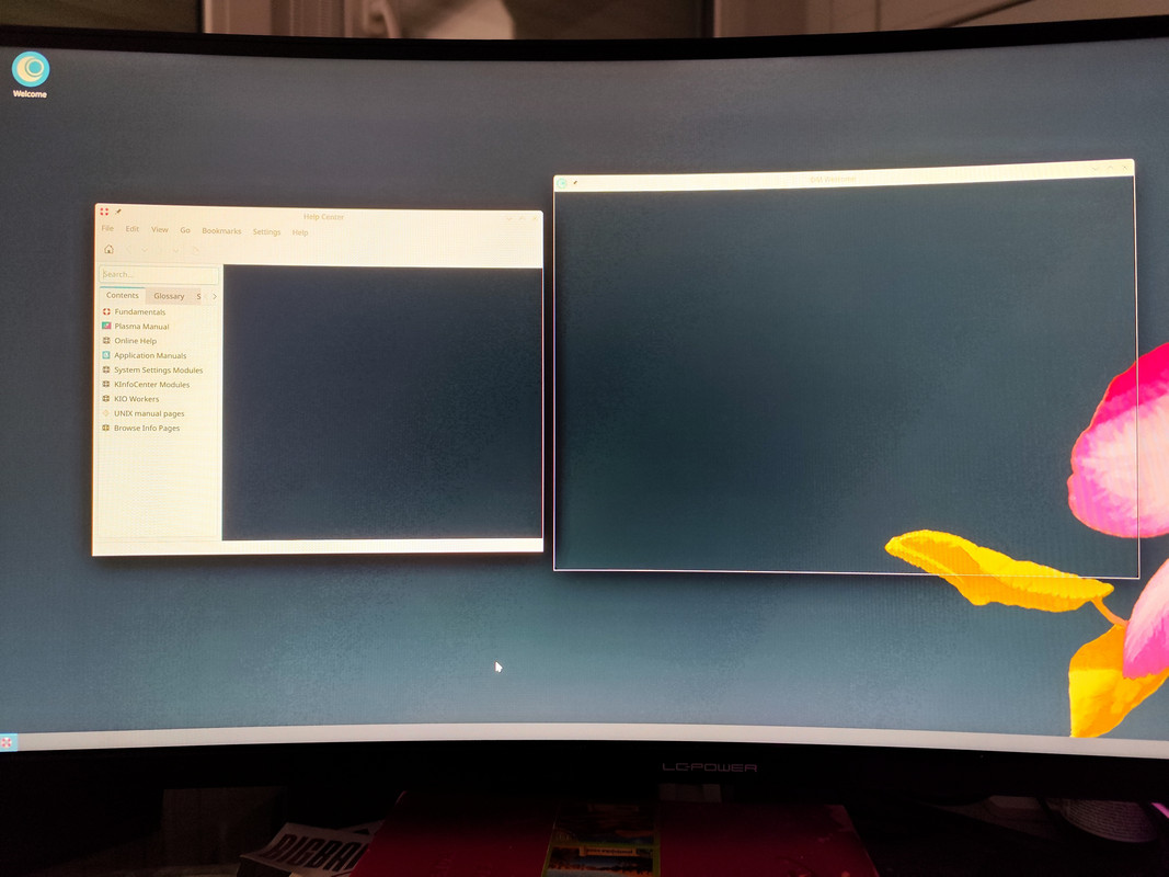

Results were similar to earlier x11 variants tests, in that “Welcome” and “Help Center” work when ruining from integrated GPU, and are malfunctioning when running from discrete GPU. However there were minor differences, for example boot was much faster on discrete GPU, and there was no popup “KWin - Crash Handler” that was showing up in x11 tests. Also instead displaying artifacts “Welcome” and “Help Center” now display empty field:
and if windows are moved then they generate artifacts like this:
