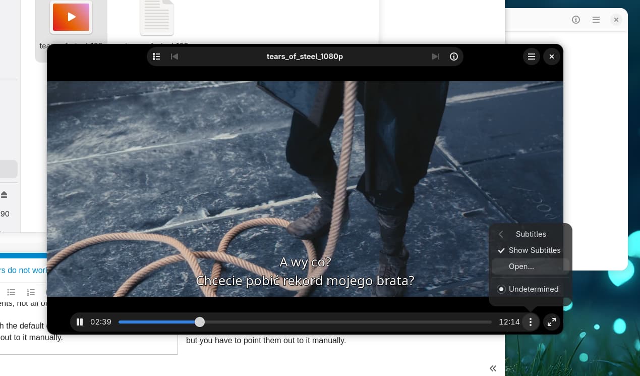

I checked on Cooker how it looks with the default clapper player and it loads subtitles, but you have to point them out to it manually.
Just like here:
I checked Showtime, and it does indeed have a problem, and the subtitles aren’t displaying.
In addition to MPV and VLC, subtitles work immediately, provided the subtitle filename is the same as the video being played.
This is after briefly checking Cooker. The problem may lie in LX 6.0. I’ll check it on LX 6.0 when I have a moment.
