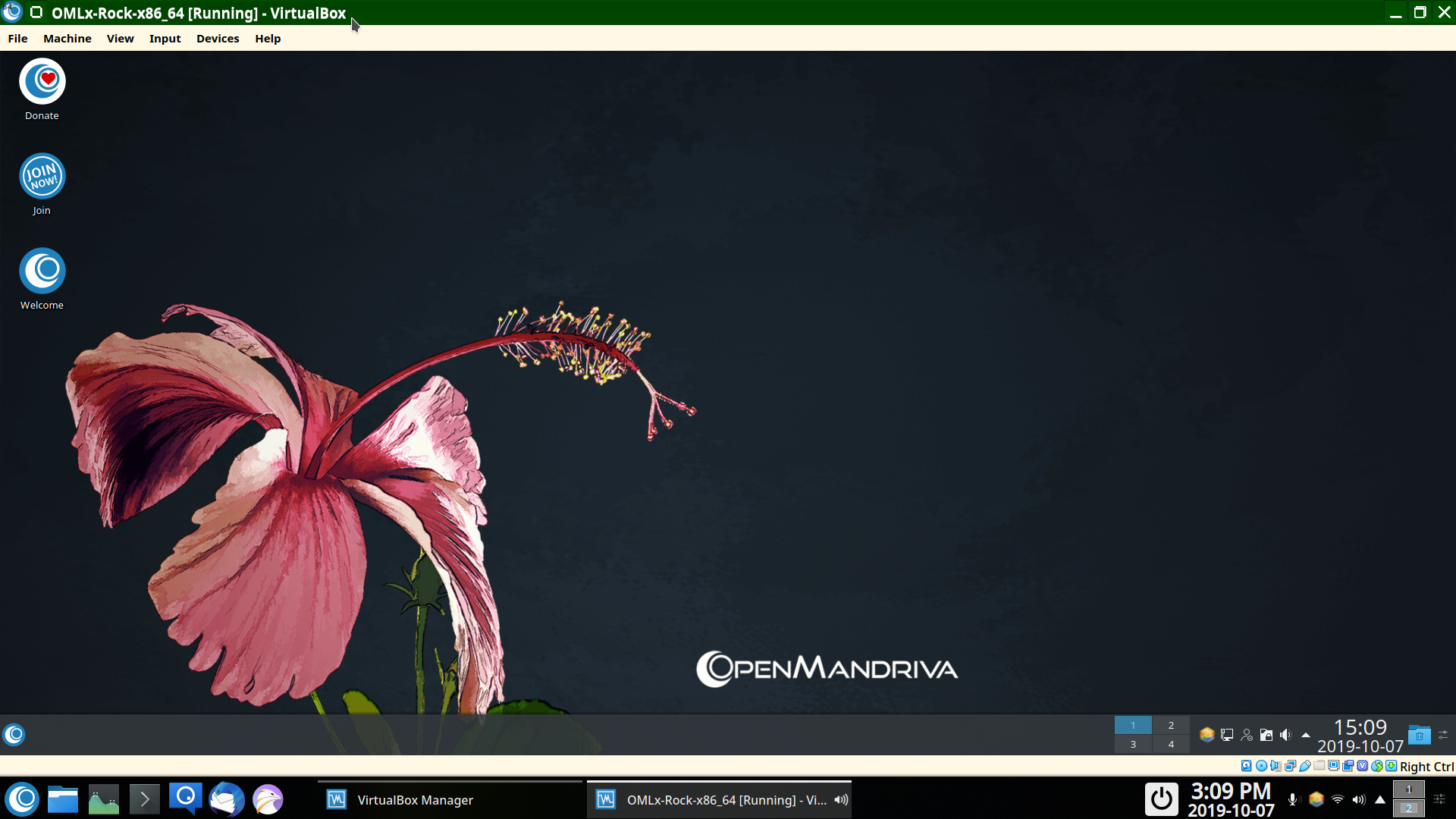

The latest version of OMLx is called either OMLx 4.0 or Rock. Here it is in VBox:
And here it is booted in to in VBox:
So it definitely works. If you are having difficulty it might be a VirtualBox setting that needs to be changed. We’ll try to help if we have enough information to do so.
