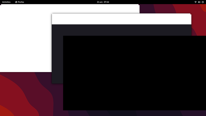

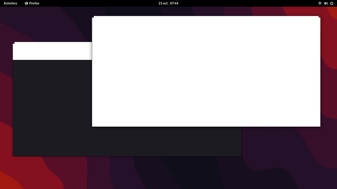

Hi!
So my issue is that firefox opens with a blurry half transparent unreadable window each time…
A few updates ago i managed to remove “hardware acceleration” inside the firefox settings.
In the latest ROME version ,even with this hardware acceleration setting switched off, the blurry window is present…
Any idea what causes the problem? Is that Mesa connected?
It happens both in wayland and xorg
My laptop is a Lenovo Thinkpad L430…
The only linux distribution that i witnessed having the same problem was ROSA gnome edition after latest upgrade as well…
Thanks a lot!
I’ll attach some screenshots

Here are screenshots from the latest firefox 106.1 available from OM rome repo:
With defaults settings (hardware acceleration ticked): add glitchy:
After the settings of performance and hardware acceleration “unticked”, then all is normal:
I did download firefox-bin from mozilla: exact same issue.
