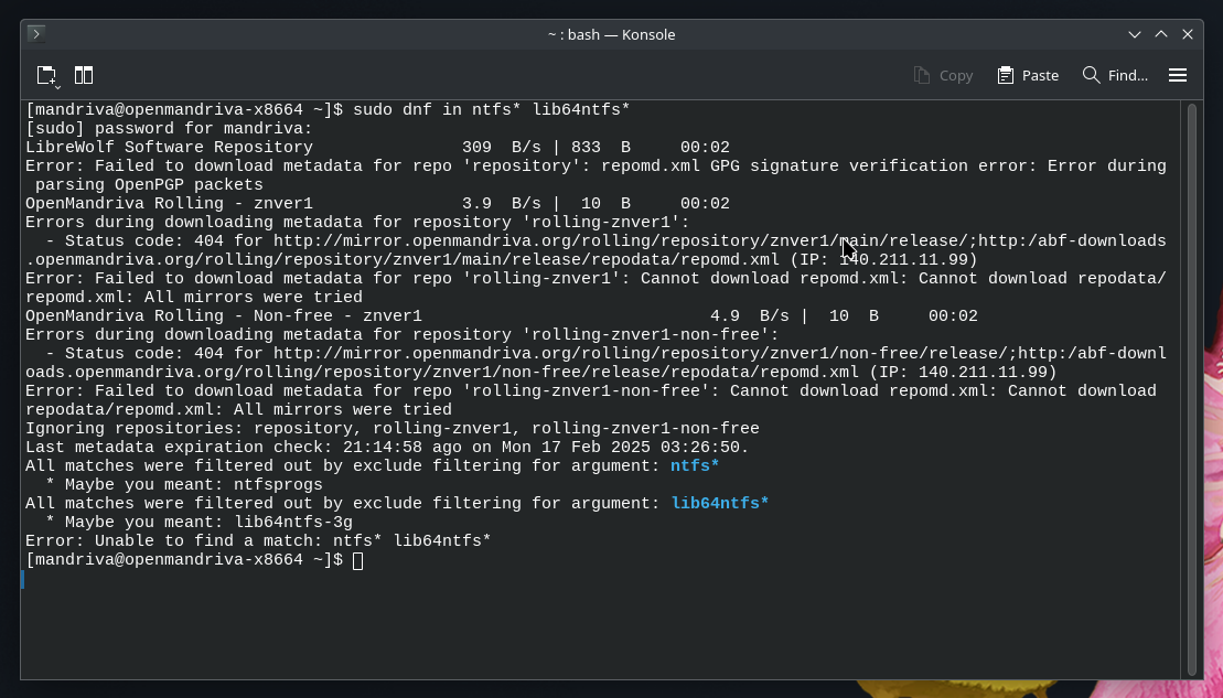

Run this command:
sudo dnf in ntfs* lib64ntfs*

Doing that command gives me errors:
sudo dnf dsync --refresh and then try again.

The errors you get are basically saying that you are having trouble connecting to those repos. If you are still unable to mount and access your drive, I think it is related to those ntfs packages I’m asking you to download.
But I can mount and access the drive. I just have to mount it manually using sudo mount -t ntfs /dev/sdd1. From here, I can see all the files on the drive just fine, but I can’t delete any, create any, or move any. Essentially I can read but not write. If I check the permission of the files, I can see they are owned by root:
