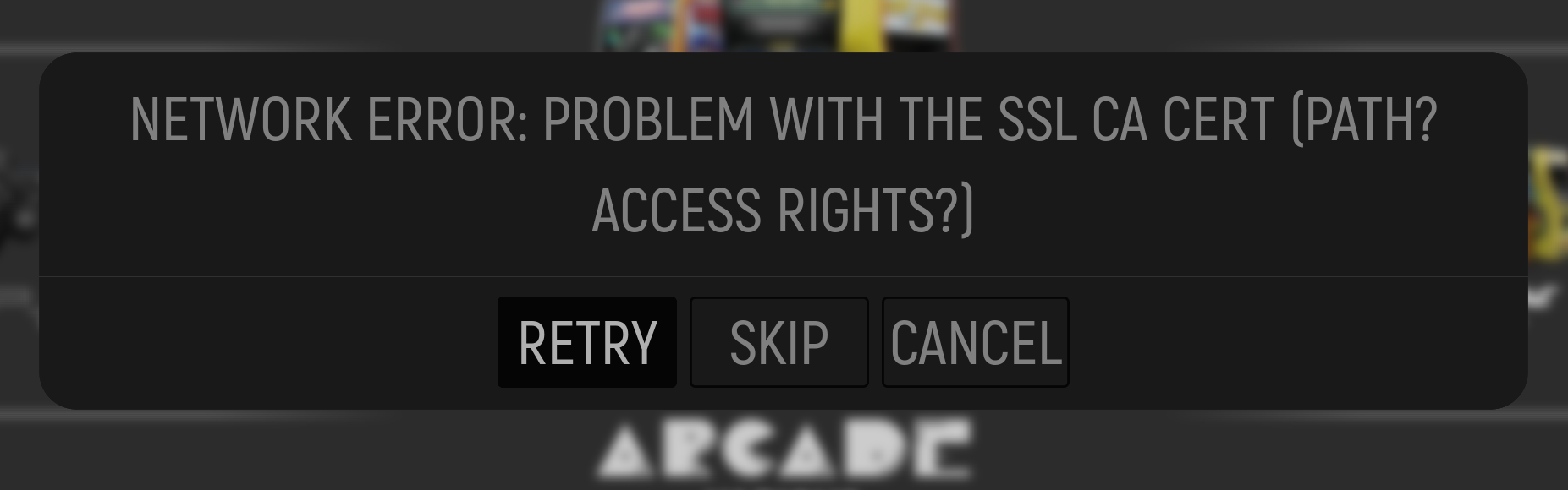

I am getting SSL Errors when I attempt to Scrape Games in ES-DE
Using ES-DE (Emulation Station Desktop Edition) Ver 3.2.
I am only having this issue in OpenMandriva. Have had this happen on multiple systems (Framework 16 laptop, HP PC with Ryzen APU)
I am not having this happen on Devuan, Bazzite or SteamOS.
