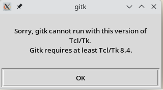

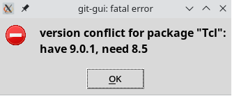

I used dnf to install git and the extras, but when I try to run git gui it shows the below error message. Similarly when I try to run gitk I also get a message about the versions. I checked and I saw that I have both packages tcl and tk installed, I get the following message in the terminal:
Last metadata expiration check: 14:08:36 ago on Sat Aug 16 21:02:49 2025.
Package tcl-9.0.1-1.x86_64 is already installed.
Package tk-9.0.1-1.x86_64 is already installed.
Dependencies resolved.
Nothing to do.
Complete!
I was wondering if there’d be any way to solve this somehow. Many thanks in advance
Error message for git gui:
version conflict for package “Tcl”: have 9.0.1, need 8.5
Error message for gitk:
Sorry, gitk cannot run with this version of Tcl/Tk. Gitk requires at least Tcl/Tk 8.4.

Now you can :wink:
Thank you! :slight_smile:
It appears to be fixed in Cooker, so it will be part of the UM:
