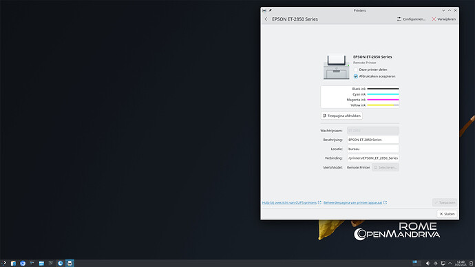

I don’t want to appear rude but apparently not everything is in there, I feel like I’m going back in time fifteen or twenty years. Back then it was also very difficult to get your printer working in linux.
There must be something missing in the iso because any other distro I install, immediately the printer is recognized?

I installed system-config-printer and entered the ip address of the printer in it, connection happened automatically
