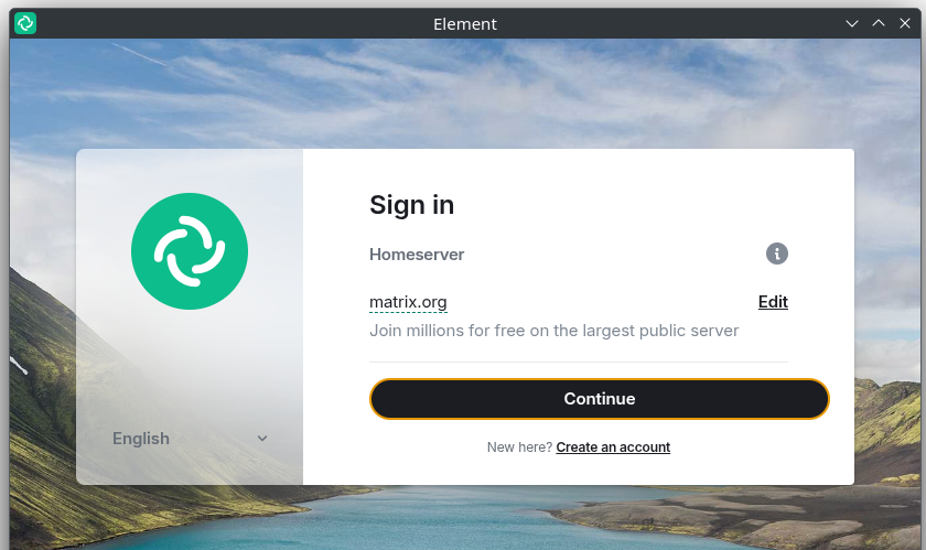

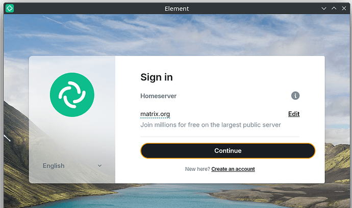

I open the fresh install of the Element flatpak and it looks normal.

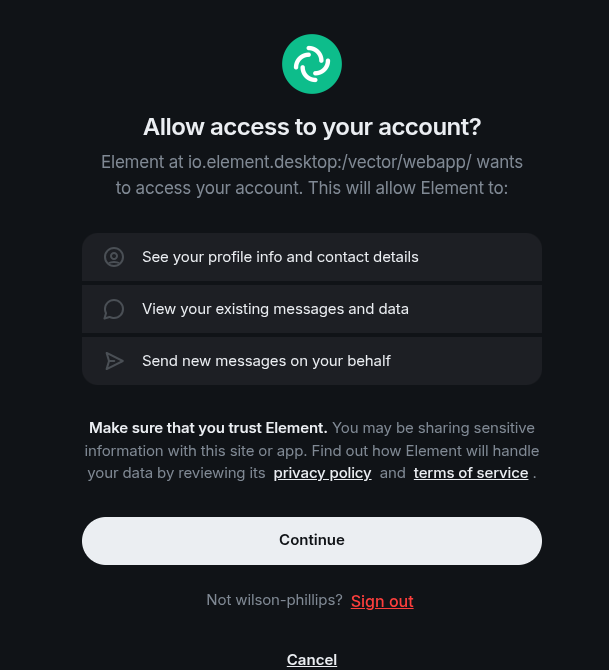

I click Continue and go to the website where I expect to authenticate and then verify the device. Looks normal.

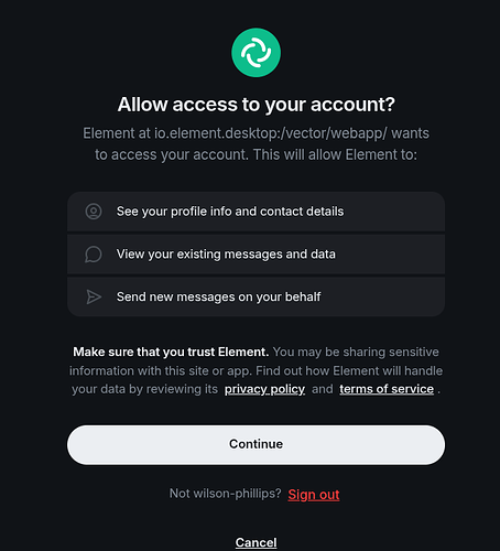

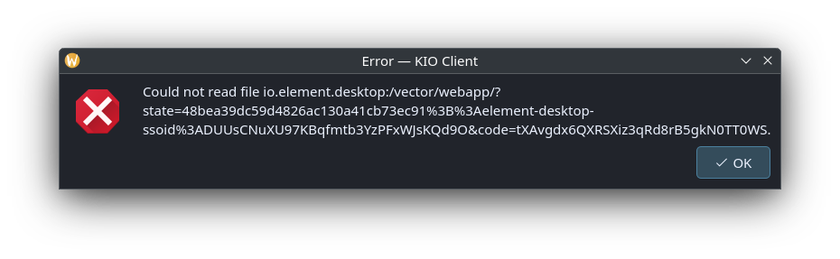

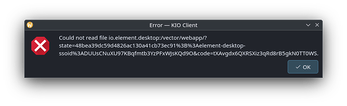

I click Continue and I get this error. The number is different each time, so I doubt I am giving away state secrets here.
What file can it not read? Is it on the website? It’s not like they are offering any support.
Unfortunately, it may need that packed into the flatpak for it to work properly. I would contact the author of the flatpak for help.

After logging in, and approving access to that account, it should be trying to save your session key. TO me it seems like the request to Kwallet via a KIO Client (?) Kwallet related issues were happening for me on Rock 5 as well, BUT the app did not crash and did work.
To be honest, most of my problems revolve around kwallet not working correctly as a key storage source. I’m about roll Rock 6 and I’ll see how things go there.
