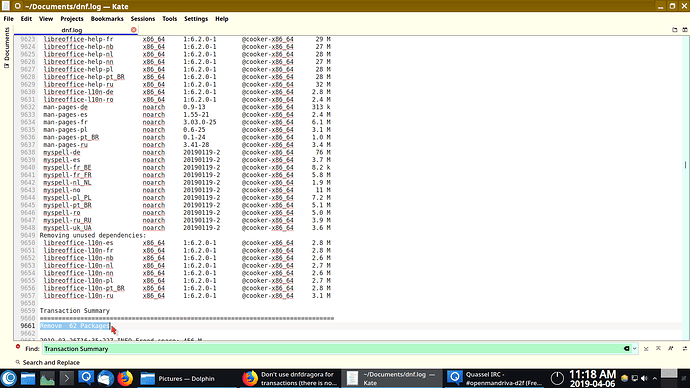

Here’s my dnf.log dnf.log.tar.xz (159.2 KB) as asked in https://forum3.openmandriva.org/t/list-of-recent-updates-how-to/2556/25?u=giorgio
dnf.rpm.log is a bit more human readable, fwiw.
Still transactions from dnfragora are not logged (anywhere in any log files that I can guess).

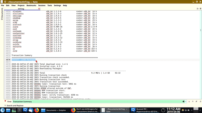

@Giorgio this is from your log.
Above is the Calamares package installation or your system. Another transaction from your log:
That transaction is a package removal where it looks like you removed unnecessary locale packages.
So your logs do have some transactions logged as they should. However we now know that dnfdragora has not been logging transactions so those won’t and aren’t in the log. Which is what this thread and bug report 2454 are about. And you did cause this to be uncovered. So thanks for that. Big thanks because this is a serious issue.
The only difference between your logs and mine is the missing transactions because of this bug. You should have no problem finding the transactions in the screen shots above.

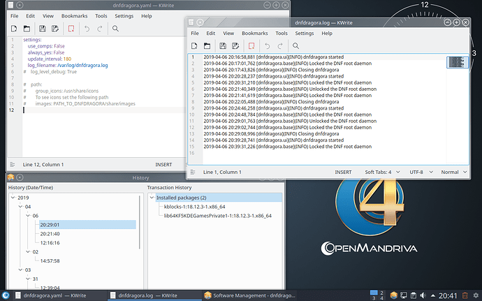

dnfdragora should collect log from installed/removed packages, if not then there is a problem.
In /etc/dnfdragora/dnfdragora.yaml is small config where we can define some options:
settings:
    use_comps: False
    always_yes: False
    update_interval: 180
#    log_filename: PATH/TO/dnfdragora.log
#    log_level_debug: True
#    path:
#        group_icons: /usr/share/icons
#        To see icons set the following path
#        images: PATH_TO_DNFDRAGORA/share/images
maybe it’s possible. If someone has time, can try to play with the change of path etc.
Maybe this help, maybe…
Man page here: dnfdragora.yaml - DNFDragora Configuration Reference
This is confirmed there is definitely a problem. dnf transactions made by dnfdragora are not being logged.
Thanks, but not working for the purpose
Aside, the file has been created in /home/user :unamused:

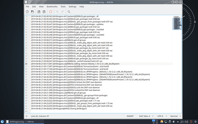

uncomment log_level_debug: True (remove #)
after this, for me log file look like this:
2019-04-06 20:55:00,297 [dnfdragora.ui](DEBUG) adding: install falkon,0,3.1.0,1,x86_64,cooker-x86_64
2019-04-06 20:55:00,310 [dnfdragora.dnf_backend](DEBUG) TransactionEvent : start-build
2019-04-06 20:55:00,469 [dnfdragora.dnf_backend](DEBUG) TransactionEvent : end-build
2019-04-06 20:55:05,074 [dnfdragora.dnf_backend](DEBUG) Downloaded : falkon-3.1.0-1-omv4000.x86_64.rpm
2019-04-06 20:55:11,074 [dnfdragora.dnf_backend](DEBUG) Downloaded : falkon-core-3.1.0-1-omv4000.x86_64.rpm
2019-04-06 20:55:17,584 [dnfdragora.dnf_backend](DEBUG) on_RPMProgress : [falkon-core,0,3.1.0,1,x86_64,cooker-x86_64]
2019-04-06 20:55:22,819 [dnfdragora.dnf_backend](DEBUG) on_RPMProgress : [falkon,0,3.1.0,1,x86_64,cooker-x86_64]
2019-04-06 20:55:38,850 [dnfdragora.dnf_backend](DEBUG) on_RPMProgress : [falkon-core,0,3.1.0,1,x86_64,cooker-x86_64]
2019-04-06 20:55:40,770 [dnfdragora.base](DEBUG) Unlock the DNF root daemon
2019-04-06 20:55:40,773 [dnfdragora.base](INFO) Unlocked the DNF root daemon
Installed falkon.
:+1:
Well, not much different from dnf.rpm.log.
43 lines of ‘DEBUG’ just to read (at line 26) remove kblocks :grin:

This has been sort of fixed. There is now a dnfdragora.log in /home/. Thank @AngryPenguin for this fix.
