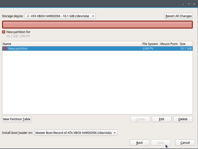

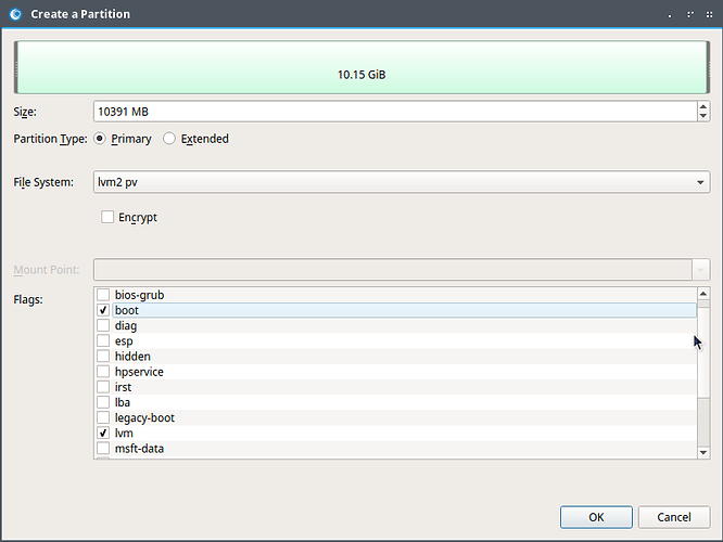

Simply I can’t find the way to create an LVM2 volume and then create partitions inside with Calamares.
Here I created a New partition table with one LVM volume

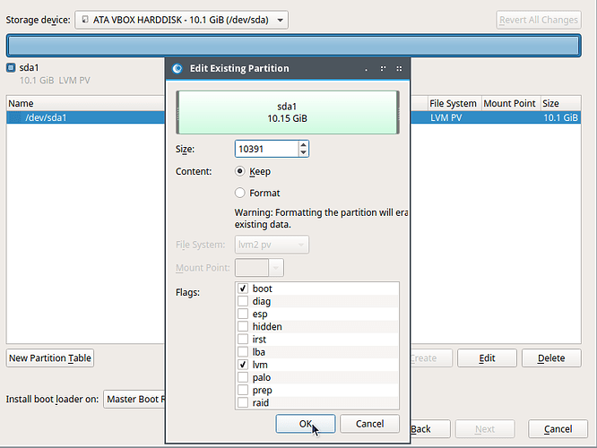

Then I can’t find a how to to create partitions inside:
Clicking on ‘Edit’ here it comes back to the preceding window.
