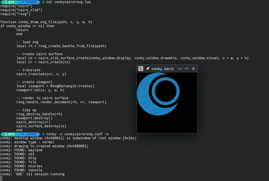

I also took a look at it and while I could get lua code to work and display properly I could not get images loading, so I delved a little deeper on that.
I updated the imlib2 library that conky uses and added a bunch more image formats to it thinking maybe we had missed something that was stopping images from loading but no success other than updating the library with more image formats, which isn’t a bad thing.
Next step was updating conky itself which went smoothy but still no Lua image tags were working and conky -v was not showing it as being enabled either, so I went back to its spec file and after some head scratching spotted a single digit typo in a macro that was preventing conky from pulling in imlib2 at all and that was the fix to get images working in conky .
You can see the output from the updated conky -v showing that it now has imlib2 enabled below:

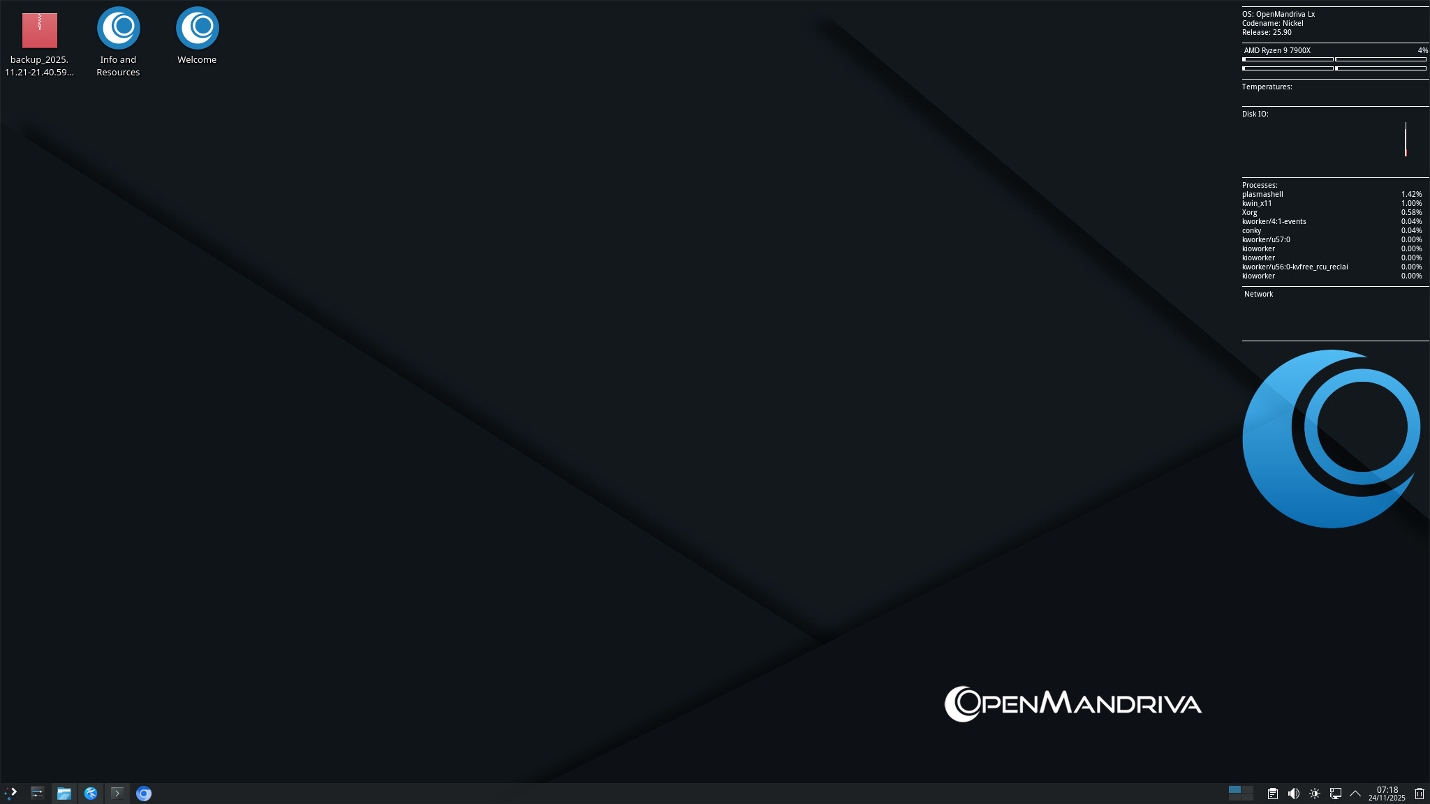

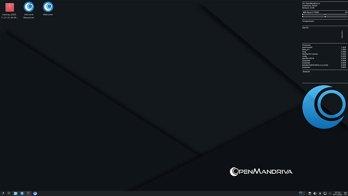

Both updated imlib2 and corky v1.22.2 packages are available in cooker and should make it down to rolling/ROME soon :tm:
Here is a screenshot of it working in a cooker VM with the OpenMandriva Lx logo loading successfully and it is all written in lua:
:melting_face:

Hello, I think I spotted the issue:
It is looking in the wrong path for conky/libcairo.so as well as that search path being malformed which seems to be something going awry in the CMake files during the build.
Thanks for providing your config files but I could not get those to work because they have many hardcoded paths and is a crazy amount of lua code for me to attempt refine for a simple repro to see if the conky cairo component is working or not.
I pulled a minimal example from the conky wiki with some modification as the wiki guide’s example is not totally complete and ran it in a terminal which was also failing to find cairo and producing the identical error as you received.
With that local repro now displaying the same error, I had something to proceed with.
A few hours later.. (had other things to do).
After some work I have it running using its cairo, cairo_xlib and rsvg component libraries from the correct paths, it is running the conky config+lua script from the wiki and rendering an svg:
As I was already in the guts of the source code and following a bunch of further local test builds I added a few more build dependencies to enable more extra options that people may find useful:

The updated conky packages are available in cooker for testing.
I would generally advise not mixing packages between Rock and cooker.
Great! That solves the problem. Now everything works as it should.
