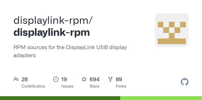

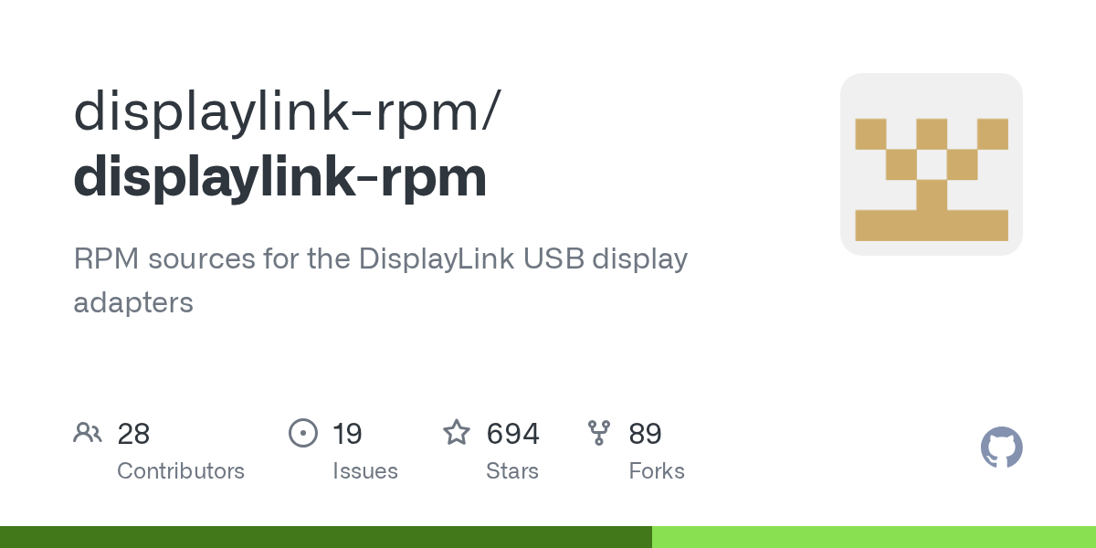

This package what it does is that it downloads the ubuntu .run file, unpacks it and it creates a 32bit and 64 bit rpm that works with fedora and other RHEL distros.
This is the driver for the displaylink Dock stations also distributed by lenovo, HP, and more.
The next links is from the developer.
