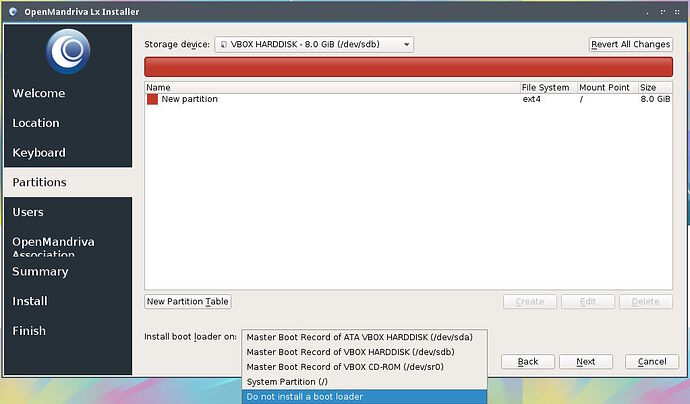

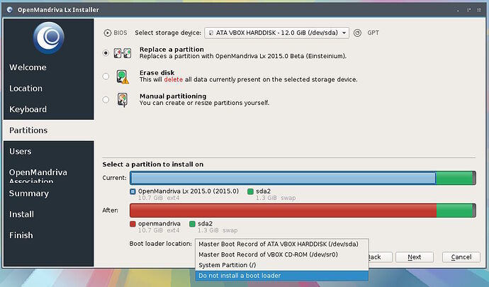

Where is the option to install without installing bootloader? I don’t see it. How do you do it?
You have the choice if you choose:
  • automatic partitioning
  • or the partition to replace
  • or after having set the root system in manual partitioning.
Example after having clicked on “current”:
Thanks, I wasn’t aware of that. I of necessity use Manual Partitioning and I can’t find any way to get that box to appear allowing an install without installing boot loader. Can you maybe look and see if you can figure it out? 2 computers are UEFI and 1 is MBR. Seems to work the same in either case.
Tried with 2014 in virtualbox. I added a second virtual disk and installed the build 106 on it, choosing to not install the bootloader. That worked. I had to add the new entry from the 2014.
In calamares, when you have created the root partition, the choice of installing or not the bootloader is available:

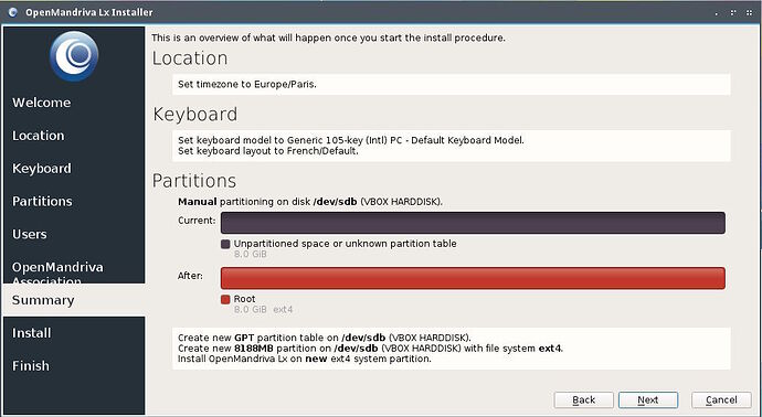

The summary doesn’t show anything about the bootloader:
But, if I choose to install the bootloader, in root partition for example, the summary shows it:
