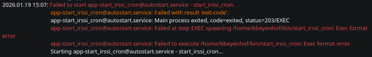

However, autostart is also failing to execute the script:
Is there anywhere that OpenMandriva expects to find a CLI script/command to run in the background on system startup?

I tried to copy it, but that’s the Autostart GUI and it wouldn’t permit me to select it as text. The journalctl output for the event is here:
Jan 19 15:07:37 augmentedfourth (ssi_cron)[1431]: app-start_irssi_cron@autostart.service: Failed to execute /home/bbeyenhof/bin/start_irssi_cron: Exec format error
Jan 19 15:07:37 augmentedfourth (ssi_cron)[1431]: app-start_irssi_cron@autostart.service: Failed at step EXEC spawning /home/bbeyenhof/bin/start_irssi_cron: Exec format error
Jan 19 15:07:37 augmentedfourth systemd[996]: app-start_irssi_cron@autostart.service: Main process exited, code=exited, status=203/EXEC
Jan 19 15:07:37 augmentedfourth systemd[996]: app-start_irssi_cron@autostart.service: Failed with result 'exit-code'.
Jan 19 15:07:37 augmentedfourth systemd[996]: Failed to start app-start_irssi_cron@autostart.service - start_irssi_cron.

Your own journal log shows that it is a Format Error with Exec:
systemd is only reporting that the service you created failed to start and exited, therefore an issue with the service you created.
I would conclude from that there is an error in how you are autostart/executing the start_irssi_cron item with your app-start_irssi_cron@autostart.service
Obviously without knowing what you are doing there we are flying entirely blind, if you cannot or wont help us to help you by providing as much detail as possible (including the code you are attempting to run) then it is not a good use of anyone’s time.
“Exec format error” typically means you’re trying to launch a binary meant for a different CPU architecture or OS, or you’re launching a script as a binary (missing markers for what interpreter should be used etc.)
The service was created by Autostart, by providing the script file as an item in its list. I didn’t write the service myself.
I gave all of that detail above. I showed a cat of the script, and I demonstrated both the cron entry I attempted and the GUI/journalctl output of including the script in Autostart (as was suggested to me). If there’s anything else specifically you’d like to see I’ll gladly show it.
Exactly! Thank you! My script, as it had been executed by cron, had no hashbang line. I put #!/bin/bash at the top of it, and now it’s executed by Autostart exactly as I’d hoped. Granted, it only runs while I have an open GUI session, but I do have SDDM doing an automatic login so it does run on every reboot. The system is headless, so I need to authenticate to VNC or SSH to get into it.

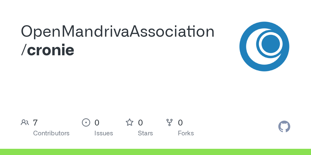

@bero Would it be appropriate to submit a pull request to the cronie specfile that would configure it to enable the service upon installation? I feel that it’s kind of useless to install cron without enabling it to run, but I don’t want to impose my assumptions/desires on a distribution when I’m still pretty new to it. I don’t know very much about culture and decision-making in the OpenMandriva community yet.
Isn’t that what this is doing?
%systemd_post does not necessarily enable a service. It just does what the distribution defines as a systemd.preset, which is configured in /lib/systemd/system-preset/ and may be supplemented in /usr/lib/systemd/system-preset/. (more documentation)

You can clone the repo I linked for cronie and provide a link in Development > Packages and features requests or in the Cooker chat. It will be reviewed when possible.
