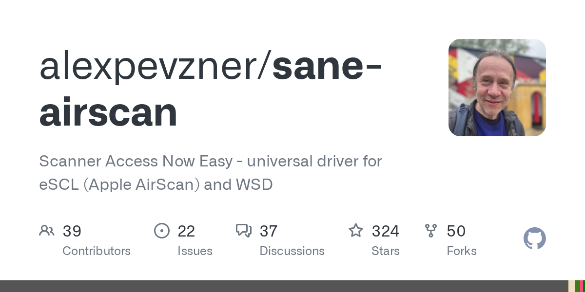

According to this we may need to add the package sane-airscan? More stuff on this:
that will be very much likely the solution :slight_smile: I would
consent
This was interesting: https://lpc.events/event/7/contributions/695/attachments/558/986/sane-airscan.pdf
yes coool ! this is it, …
many thanks for your research
