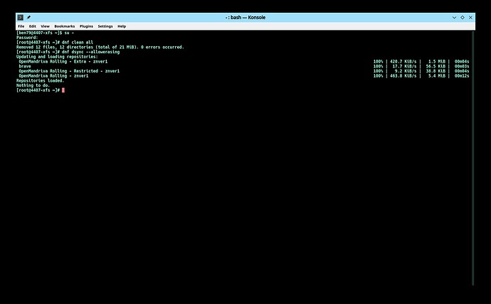

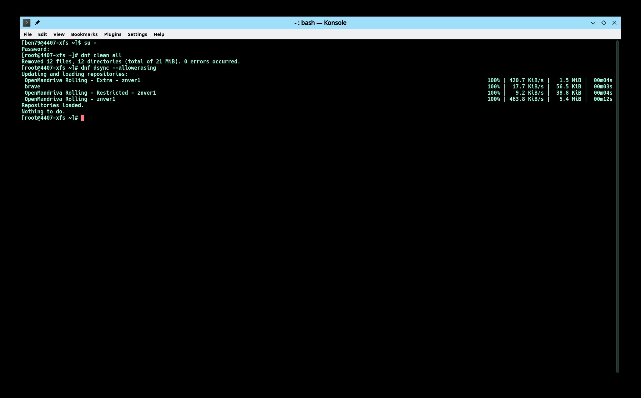

An update on the. @bero today published again the existing lib64svt-av1_0-2.3.0 package to rolling main repo so this error should disappear from users dnf dsync dialog. The newer, for now useless, package is in rolling main testing repo.
awesome work guys - thank you.
