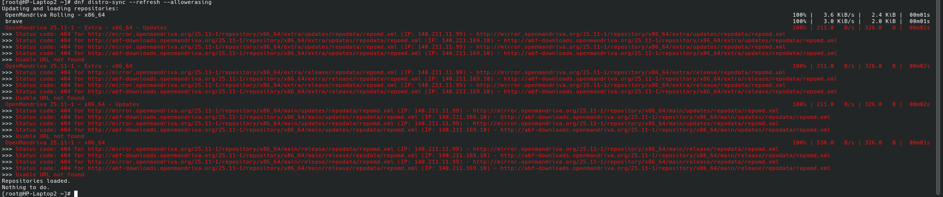

# dnf --refresh distro-sync --allowerasing
 brave                                                                                                                                                                                                                                100% |  22.7 KiB/s |   2.0 KiB |  00m00s
 OpenMandriva 25.11-1 - x86_64                                                                                                                                                                                                        100% | 352.0   B/s | 326.0   B |  00m01s
>>> Status code: 404 for http://mirror.openmandriva.org/25.11-1/repository/x86_64/main/release/repodata/repomd.xml (IP: 140.211.11.99) - http://mirror.openmandriva.org/25.11-1/repository/x86_64/main/release/repodata/repomd.xml
>>> Status code: 404 for http://abf-downloads.openmandriva.org/25.11-1/repository/x86_64/main/release/repodata/repomd.xml (IP: 140.211.169.10) - http://abf-downloads.openmandriva.org/25.11-1/repository/x86_64/main/release/repodata/repomd.xml
>>> Usable URL not found
Repositories loaded.
Nothing to do.

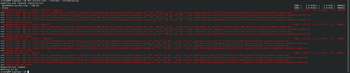

 OpenMandriva 25.11-1 - x86_64                                                                                                                                                                                                        100% | 204.0   B/s | 326.0   B |  00m02s
 brave                                                                                                                                                                                                                                100% |  30.3 KiB/s |  54.5 KiB |  00m02s
Nothing to do.

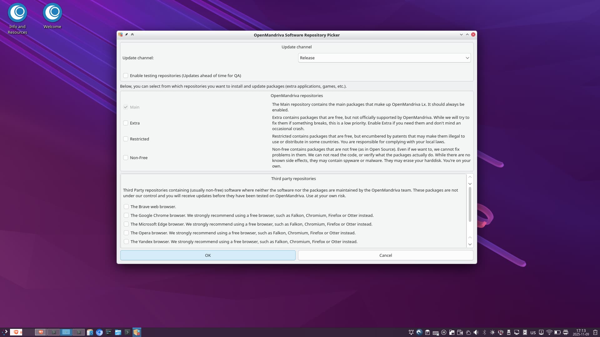

if the problem happened when you managed the repos with Repository Selector please don’t do it again as we need to confirm or not the issue.
It should not be set to “Release”. You will never have a need to set it to that unless you are testing something and are told to change it to that.

What this is showing?
hey,
i never did anything! i plead ‘not guilty!’, your honor! :innocent:
i just started to sniff around after the failure occurred. i suspect the infamous Repository Selector in combination with dnf’s mysterious source of repositories.
greetings…

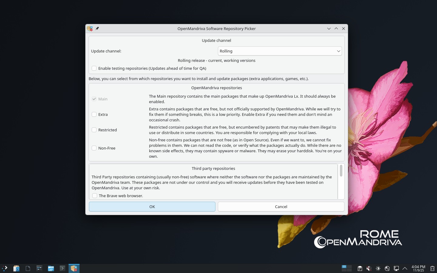

Ok, what happens if you select ‘Rolling’ ?
You have the backup anyway.
hey,
i changed to ‘Rolling’, and then this happens:
# dnf distro-sync --refresh --allowerasing
 OpenMandriva Rolling - x86_64                                                                                                                                                                                                        100% |   2.3 MiB/s |   5.7 MiB |  00m02s
Package                                                                                       Arch                Version                                                                                       Repository                                                Size
Upgrading:
 lsb-release                                                                                  noarch              3.3-1.2511                                                                                    rolling-x86_64                                        12.9 KiB
   replacing lsb-release                                                                      noarch              3.3-1.2506                                                                                    rolling-x86_64                                        12.9 KiB
Transaction Summary:
 Upgrading:          1 package
 Replacing:          1 package
Total size of inbound packages is 13 KiB. Need to download 13 KiB.
After this operation, 0 B extra will be used (install 13 KiB, remove 13 KiB).
Is this ok [y/N]:
Operation aborted by the user.
so it seems, it is working again! :+1:

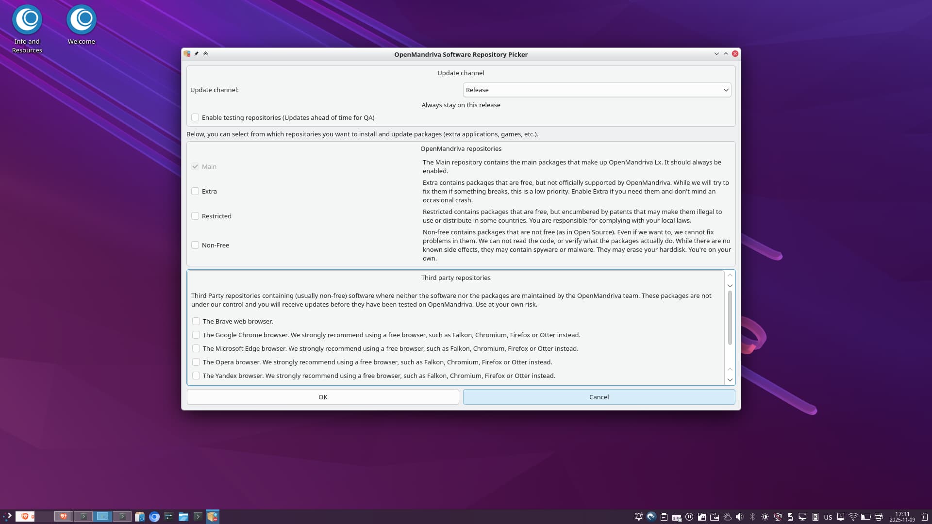

but, curious as i am, i immediately tried it again (enabling the extra repo), and:
a subsequent start of the infamous Repository Selector shows:
so it seems, there is a reason it is called the ‘Infamous Repository Selector’… :rofl:
ok… now, that i know how to repair it, i am a little bit more relaxed.

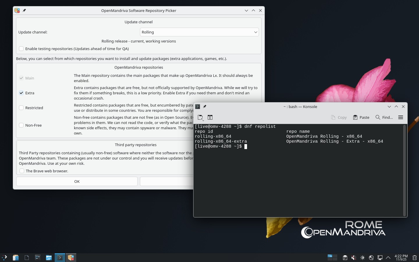

Same here. I’m curious to know how it happened.
Actually I’m testing in live iso and have to report that it works as expected there.
Next step is to test in installed system, hopefully catch what may be wrong, and finally release a fix.
Btw in your dnf5.log around line 250/251 it starts to mention `25.11-1. Maybe a starting point for debug (?)
