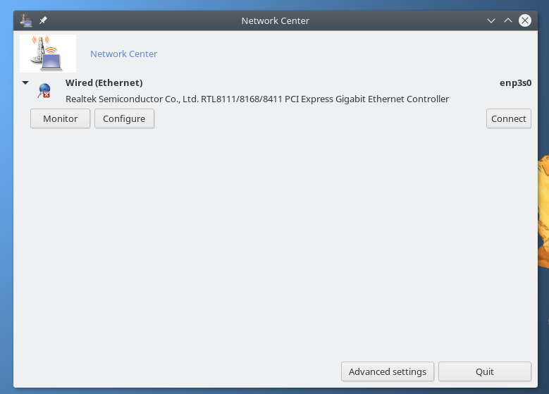

I disabled the firewall and tried again but to no avail. I noticed in the network centre that the wired (ethernet) - enp3s0 is disabled. It never activates no matter how much I click on the connect button. The following screenshot will help.
Okay I can see how this can be confusing because in OpenMandriva there are 2 tools provided to configure internet. (And I hope this all makes sense).
Network Center - real name - drakx-net - this is strictly a Mandrake/Mandriva/OpenMandriva tool. It is also old, deprecated, written in Perl, and most important is not working for you.
NetworkManager - real name - I don’t know what other LInux distros call it I only know NetworkManager. It is the more modern tool and is used by most (not all) modern Linux distros.
First thing to do is stop using Network Center and use NetworkManager. (I wish we didn’t have both but we do for now.) You’ve seen NetworkManager in other Linux distros. Again it is the icon or applet in system tray I’ve told about in earlier post. It looks like this:
