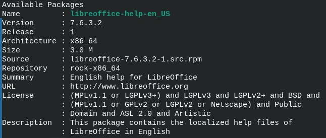

Have you double checked to make sure the language pack help files are installed? I just verified that the help files are not installed by default. So, for example, if your language is “US English”, then you want to a dnf info libreoffice-help-en_US from the terminal and you should see something like this:
N.B. on this system the package is available to be installed.
