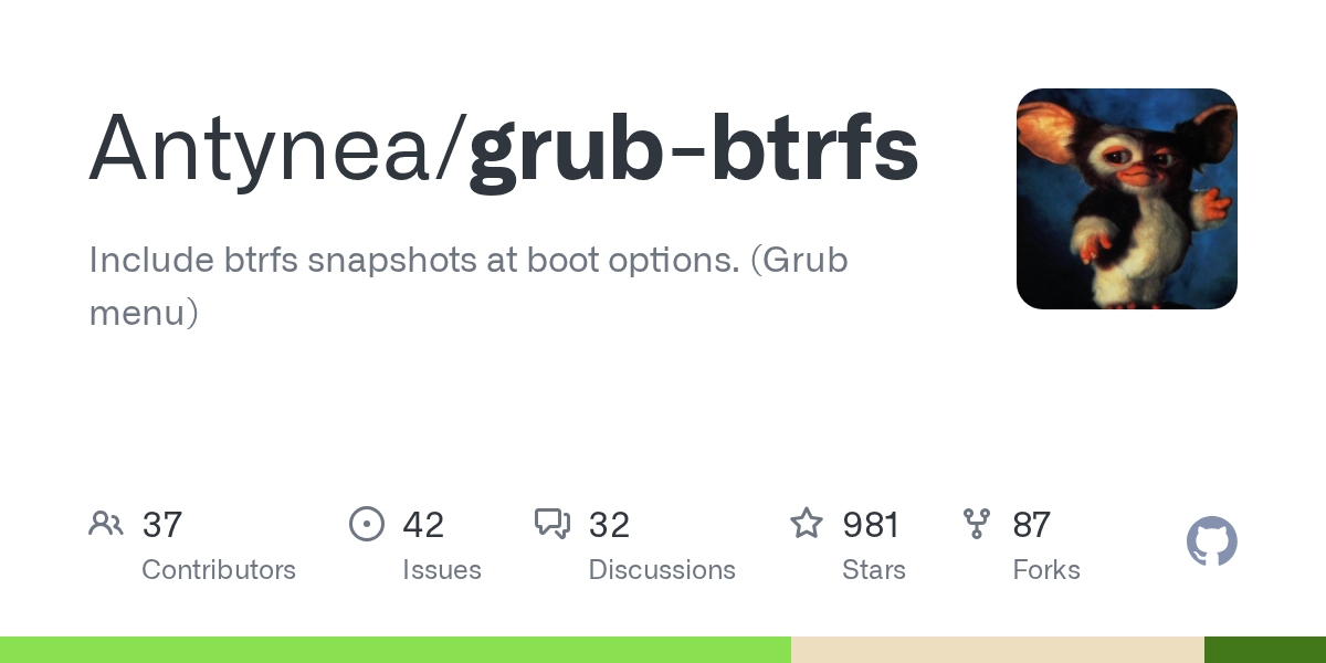

@jamez1510 absolutely, timeshift is awesome. As far as I know, it doesn’t automatically create entries in grub to boot from an earlier snapshot. Or is there a plugin in the repo?
It’s been a while, but I think the package is grub-btrfs

Second, in GRUB, we don’t have timeshift snapshots because the package for grub-btrfs or whatever we need to surface timeshift snapshots is–as far as I can tell–not in our repos. While I would make a plea that those packages be found and included for the sake of usability, help me understand the options we do have. I’ve seen recover and CLI in the advanced GRUB options. Would those allow an average user to boot into an environment where Timeshift rollback (or any other necessary maintenance) could occur in order that the system could be brought back to a working condition? I’m guessing the answer is, “well, duh” but I’m just looking for the yes/no answer.
I am just about to do a search for grub-btrfs and see if I can put in a package request for it. Maybe then, I can talk @zeroability into helping be put it into the template and build it. However, I am not sure we even need that?

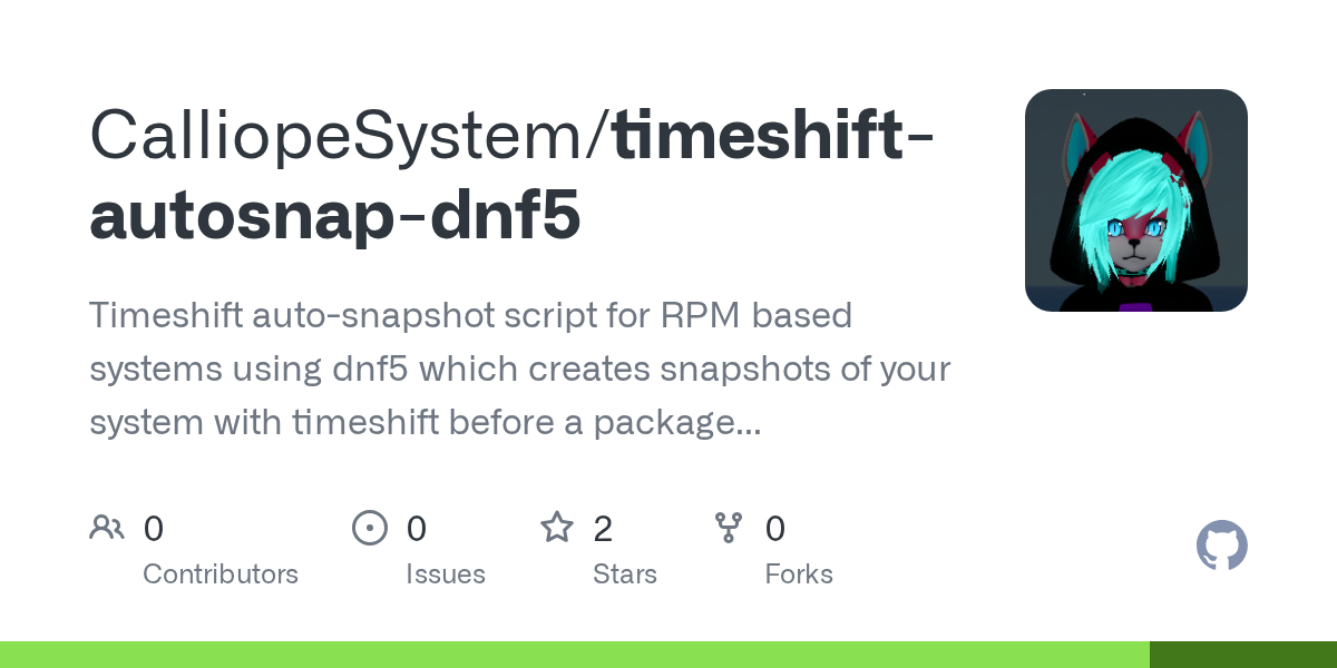

Also, I don’t see timeshift-autosnap in the repos.
You can, and it’s here:
From what I can tell, it is exclusively a pacman helper script:

I found a great github page, that helps you setup autosnap with dnf and grub-btrfs
I’m going to set it up and see how it goes. (edit: it looks like it is DNF5, and we’re currently on 4.2, so I guess I’ll wait, lol)
Cooker and ROME dnf5 too.
Interesting, I’m running ROME, but when I run dnf --version, I get 4.2.
