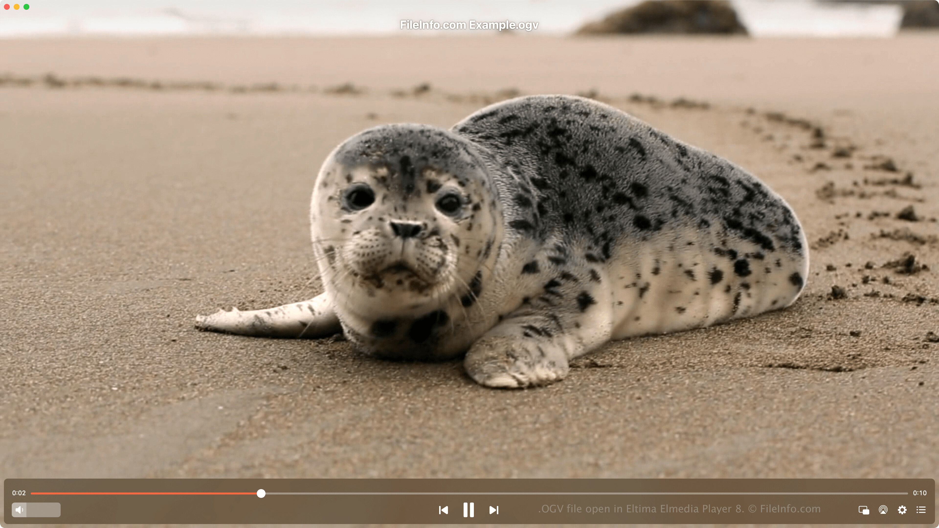

I suspect it’s related to the kernel, video drivers, or ffmpeg. Those tend to be the usual suspects. Since you brought up video playback, I would try to find some Vorbis videos and play them in Brave to see if the issue can be reproduced.
Vorbis videos you said. It is some lead. Vorbis is a audio codec. Ill try to create some dummy video with vorbis in it to see if it crash brave
No crash so far
Try opening the extension settings
Just to clarify for others:
yup i know what ogg or ogv is :slightly_smiling_face:
