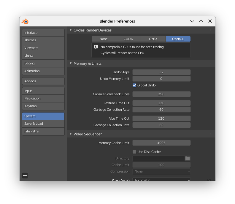

Hello, I have an issue with Blender rendering engines that use GPU(Cycles and Radeon ProRender). I can’t select my Radeon GPU because Blender cant see it for some reason.
OpenMandriva Lx release 25.90 (Nickel) Cooker for znver1
KDE Plasma 6
When I open any version of Blender with Cycles there’s no GPU in edit->Preferences->System
My Hardware.txt (3,1 КБ), checked Blender versions 2.79b/2.93/4.5, also tried on OM Rock 6.

I thought this package was pre-installed on my system, but it is not, rocm-opencl is not installed. And apparently I’ll have to wait for the Openmandriva cooker repositories to be updated because dnf can’t find the dependencies for the rocm-comgr package that rocm-opencl needs. Thank you for your reply!

they were all enabled in cooker. Right now i’m on OM Rock 6 and Blender Cycles are working great while radeon ProRender still not seeing my GPU, probably because of this issue blender is showing in the debug mode when going into system in preferences
KFD does not support xnack mode query. ROCr must assume xnack is disabled. LoadLib(libhsa-amd-aqlprofile64.so) failed: libhsa-amd-aqlprofile64.so: cannot open shared object file: No such file or directory
But i think ill just stick to cycles for now.
