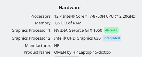

I have installed the Nvidia drivers from OM-Welcome. After rebooting, the OM-Welcome screen is black.
(I installed the drivers them because games on steam were slow, but now they freezes)
I’ve come across posts mentioning to set an option to hybrid in BIOS, but my BIOS options are limited (and I can’t do anything to display the more advanced options).
I’m new to linux, so I don’t really know what to do?
Laptop with integrated graphics and a graphic card.

Thank you, I managed to install it. When switching to integrated, it works normally.
However, I need to use the hybrid or nvidia mode (otherwise games are too slow). But in those modes, I still have the issue of OM-Welcome displaying just a black screen and games crashing… I’m not sure what else to do? Are there more drivers than the Nvidia drivers from the OM-welcome that I need to install?
We have some reports of certain setups not working without nvidia-prime. It was recently added to our development version Cooker. @rugyada may have created a test package for it, but I don’t think one was made for 6.0.
Normally, you want only the nvidia card configured/enabled in BIOS. Please also make sure your system firmware (BIOS) is up to date.

nvidia-prime is in /non-free repo, just published also for ROME and 6.0
Thank you! I’ll check it out.
