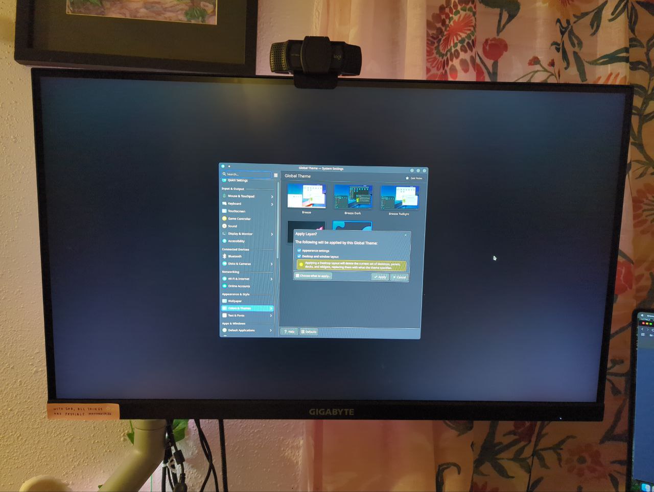

  • After a fresh install of the KDE lite version of Rome, I applied a theme (Layan) and additionally checked the Desktop and window layout option. On applying this, the entire desktop goes black and I can no longer interact with the desktop. Upon rebooting, I can no longer boot into OpenMandriva as my installation seems to be corrupted. This is my second time producing this so it seems to be reproducible, at least for me.
I have a photo but it doesn’t seem to be possible to upload photos here.

I modified your level, so you should be able to edit the post and add a screenshot.

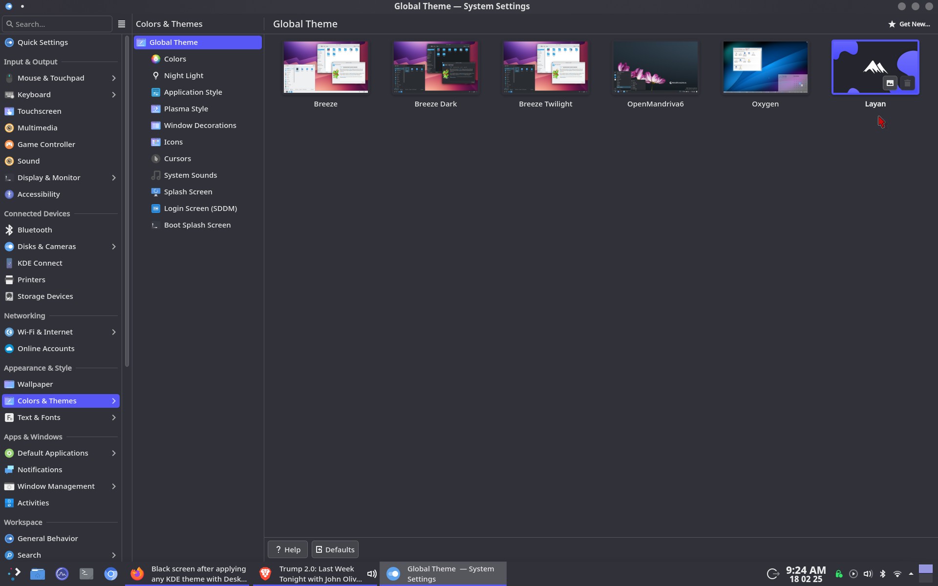

I installed the Layan Global theme and looks like it works here. After it installed I first selected the “Use” button in SystemSettings and that produced an error:
But then I selected Layan and Apply and it seems to work:
Edit: I am using X11.

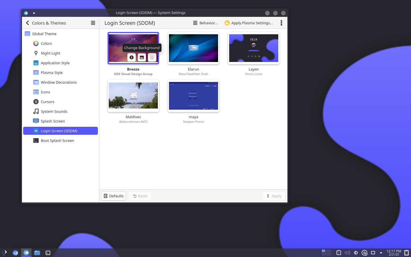

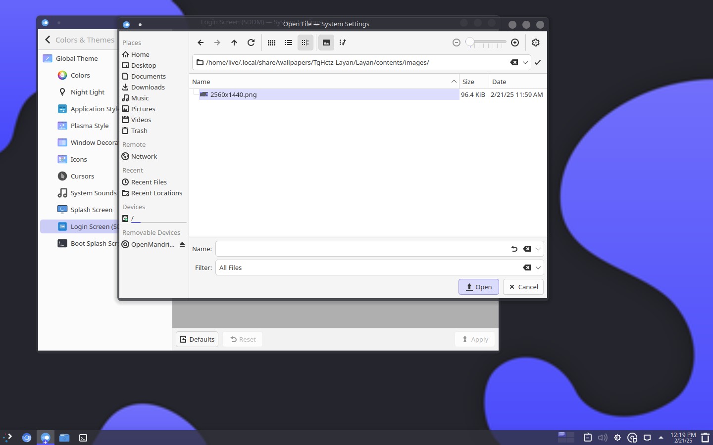

The Layan sddm theme does not work.
Use Breeze and change the background
Note: the theme layout is broken as well.
That’s what made the desktop mess :slight_smile:
