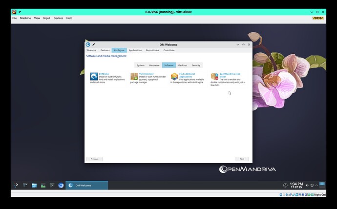

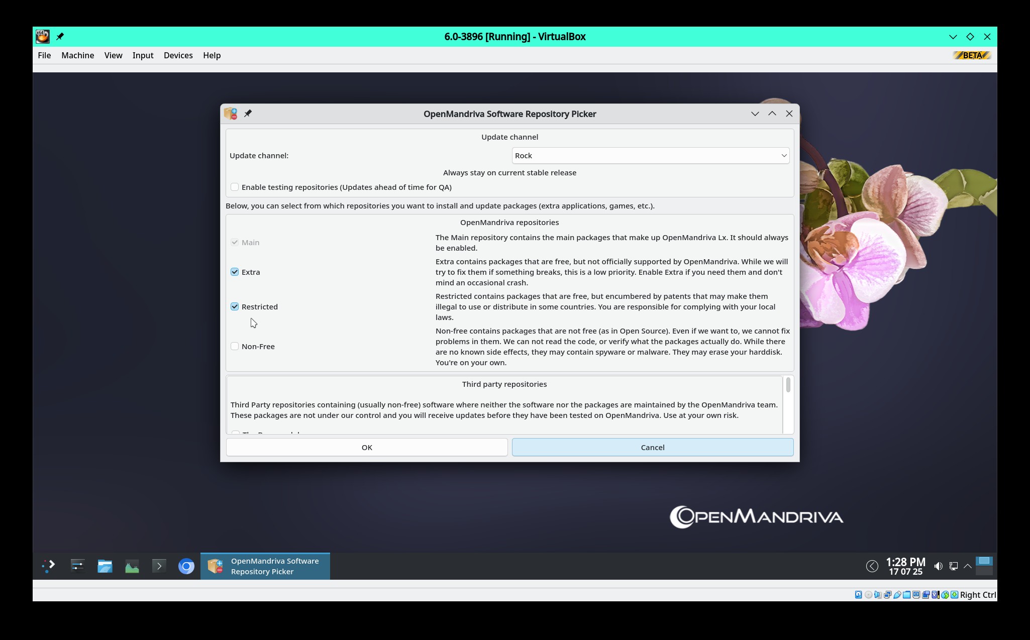

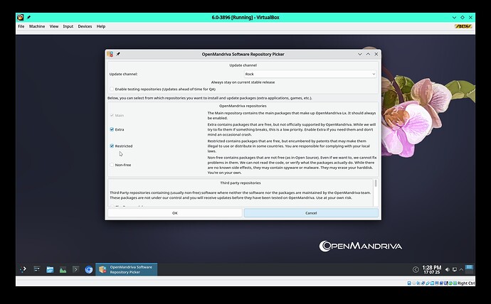

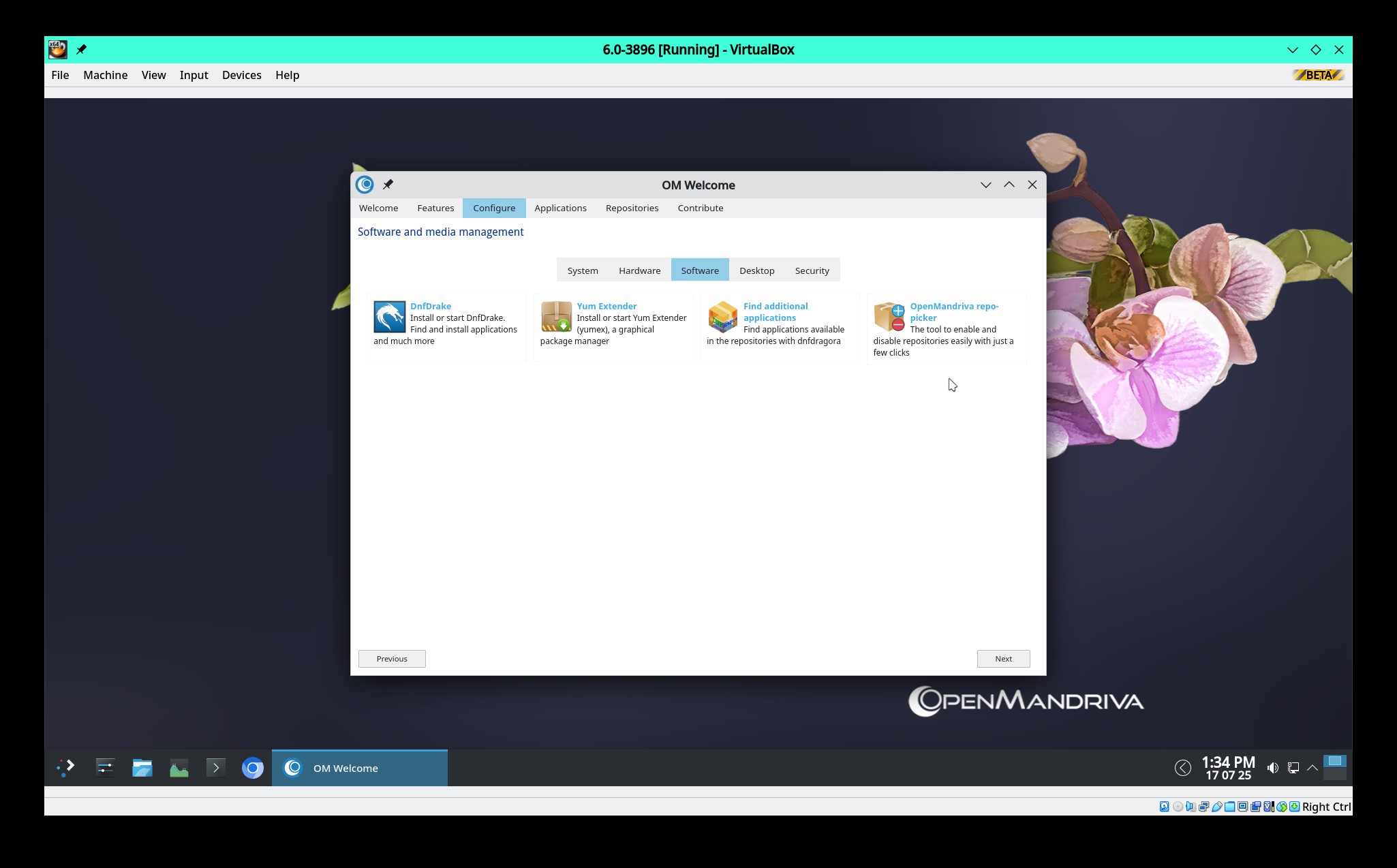

Software packages are in repositories. On first boot after installing OMLx only the Main repository is available. There are 3 other repositories a user might enable Extra, Non-free, and Restricted. You can enable these with the “Software Repository Selector” also called “OpenMandriva repo-picker” which you can find in OM-Welcome under Configure>Software :
As you can see I have enabled Extra and Restricted. There is a brief description of each repo there. Some users might need Non-free if, for example, they want to install nVidia proprietary drivers. Which repositories you enable is up to you but obviously you can enable or disable them at any time as you wish. Note there are also some 3rd party repositories available to install such things as Brave browser, Chrome, Opeera, Vivaldi and other. 3rd party means that this software is controlled by that 3rd party these are not OpenMandriva software.
Next to keep your system up to date there is also in OM-Welcome under Configure>System the System Update utility:
You can also see in OM-Welcome there are other things you can do from there I’ll leave that for users to explore with one note. Under Applications some items where the explanation starts with “Add third party and install ” that will only add the third party repository, the user will need to install the application. I know this is true for Vivaldi and Google Chrome but for others like Brave browser that button does install the application, so this is perhaps a work in progress by a hard working developer.

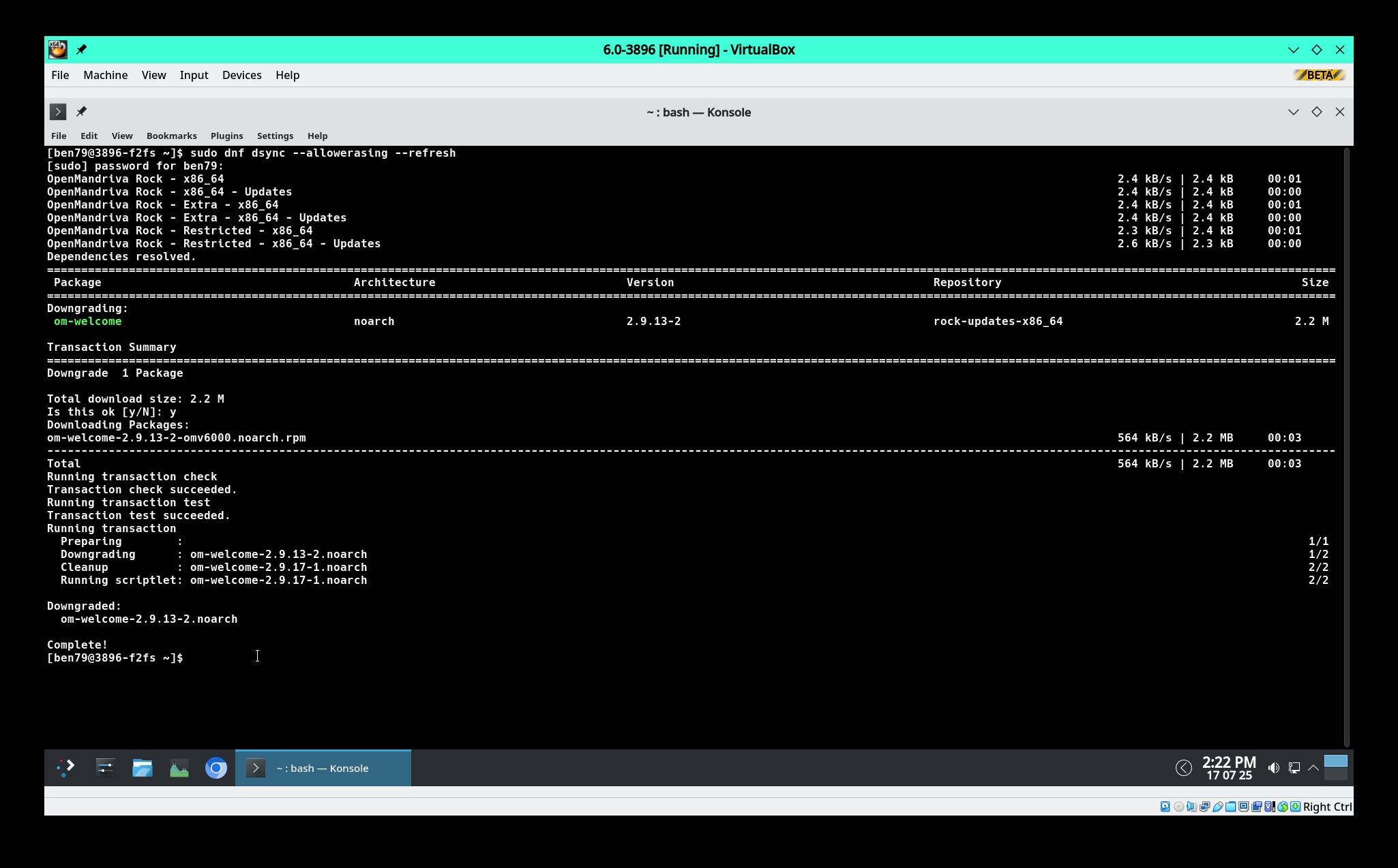

To keep your OMLx system up to date you would use:
sudo dnf dsync --allowerasing --refresh
dsync
is an alias or abbreviation of distro-sync
, OpenMandriva uses this command instead of dnf upgrade
to keep systems up to date. The why is more technical than we need to get in to here.
You can see we have one package to upgrade and we select y
for yes of N
for no to do the upgrade.

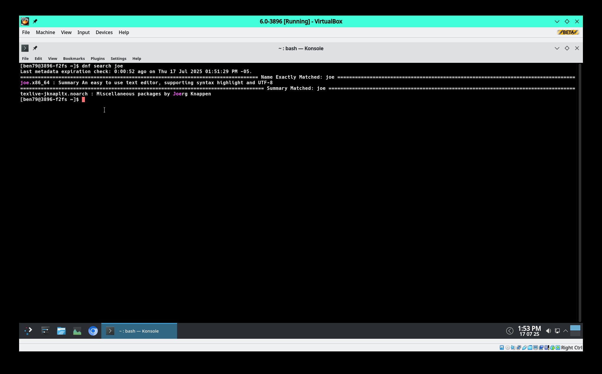

To find software you would use:
dnf search <package_name>
Use the simple text editor joe
as an example:
dnf search
will also work with partial names.

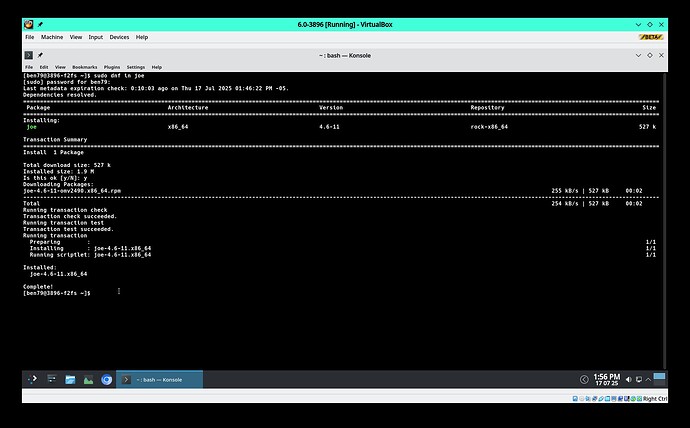

Next to install software:
sudo dnf in <package_name>
in
is an alias or abbreviation of install
. To install or remove packages the name must be exact. For example we can install joe

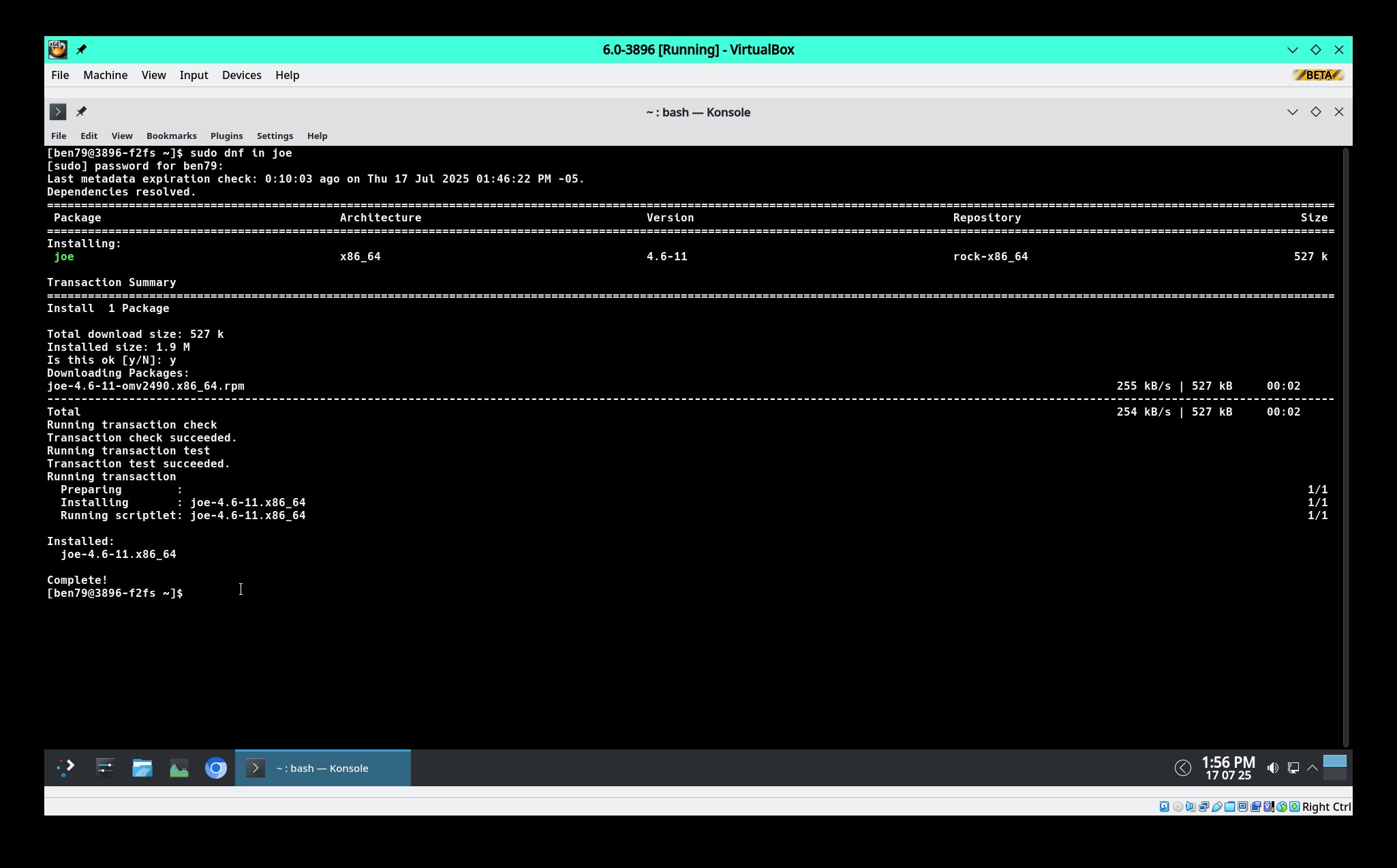

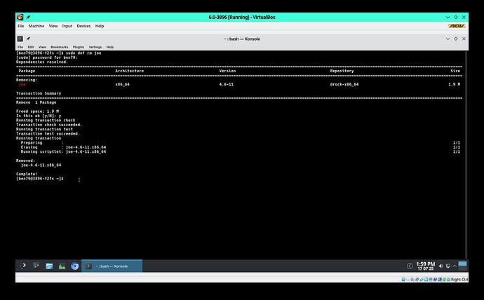

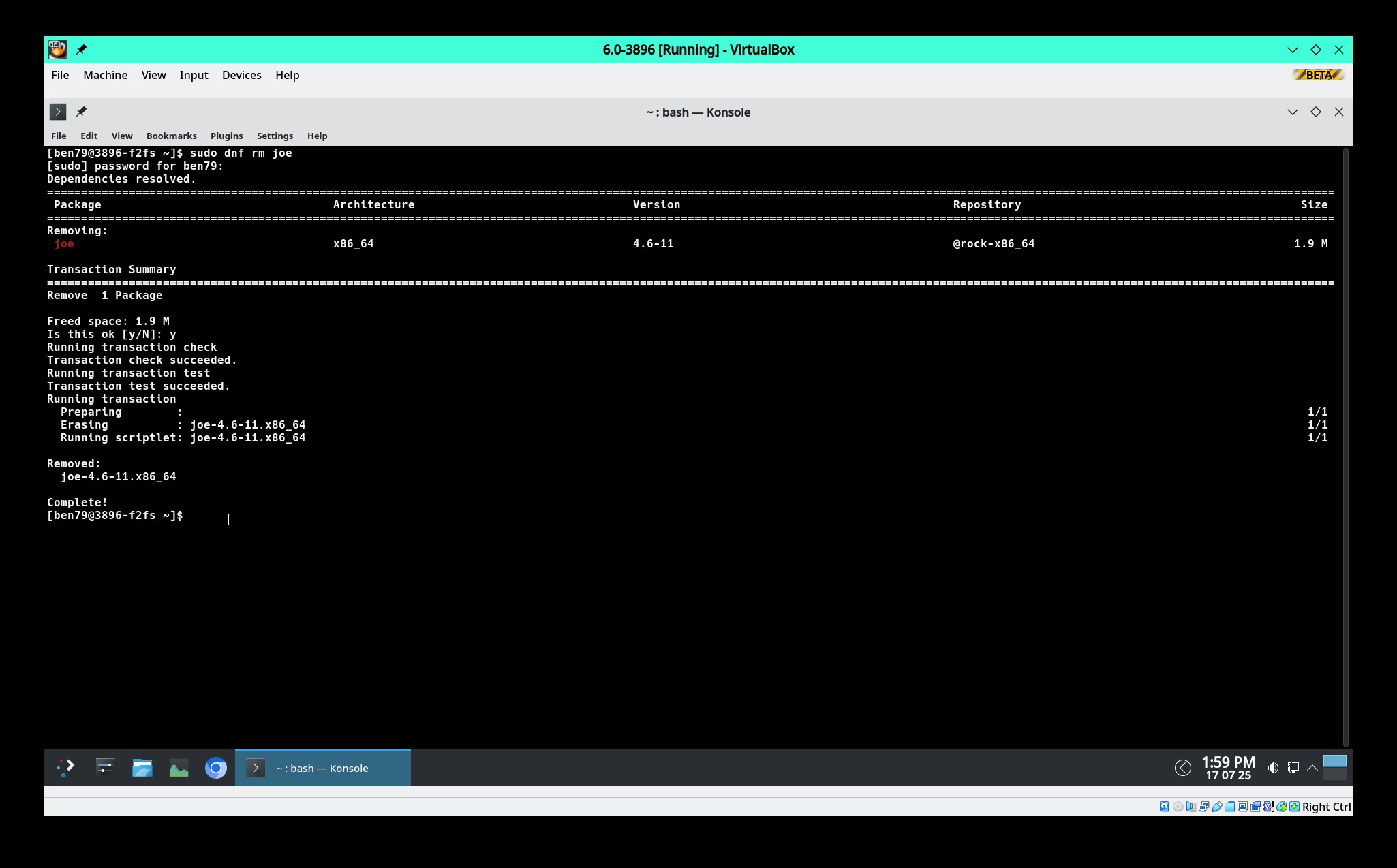

Now we can remove a package:
sudo dnf rm <package_name>
rm
is an alias or abbreviation of remove
. Using joe
as an example:
