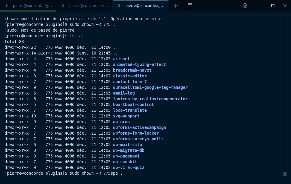

Any way to prevent sudo chown -R 775 please?
Mandrake Kings & Queens,
Just by curiosity is there a way to prevent wrong terminal command ?
Security feature ? One or two times a year stuff like that happened to me :triumph:
Was trying to solve Wordpress upgrade error on local. I meant chmod of course but it’s not the first time I made this kind of mistake. I can survive for sure but if there is something similar to “sl” or a way to get a warning ?
Thank you in advance for your help,
Peter

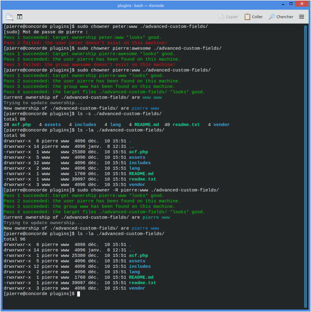

Sunday Shell Scripting! Well I ended creating my own script in /usr/bin/chowner.
It took me a few hours :sweat_drops:… Bidouilleur du dimanche bonjour !
#!/bin/bash -e
# /usr/bin/chowner

I just use it like that :
sudo chowner -R pierre:www /my_plugins/
Example :
It’s working pretty good actually
