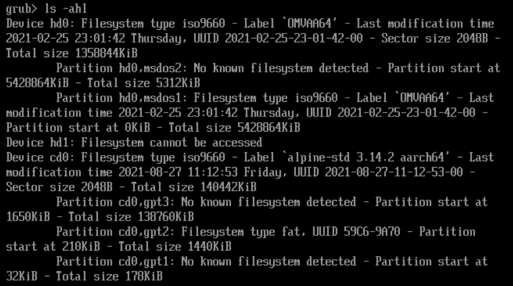

I’m trying to get an installation of LX 4.2 running on QEMU via UTM for macOS (ARM), and am having problems loading grub from the ISO (release/4.2 /final/AArch64 server/aarch-uefi-iso.iso), as it appears that the UEFI cannot open the partitions on the ISO.
In contrast, ISOs from another distro appear to be recognized without issue.
Here’s a set screenshots from EFI shell. I have two ISOs mounted as USB CD-ROM.
BLK4 and BLK5 are the partitions from the LX ISO, and BLK2 is the EFI partition from the other ISO.
Screen Shot 2021-09-11 at 8.39.32 PM
In addition, here are some screenshots from grub shell (booted from another ISO).
Looks like the LX ISO is being recognized as a hard drive instead of a CD(?)
