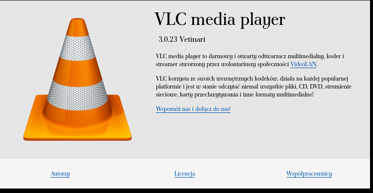

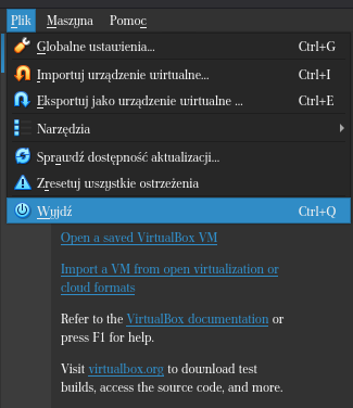

Ugly fonts in programs (QT) like VLC and VirtualBox
After installation, I noticed ugly fonts in programs like VLC and VirtualBox.
OpenMandriva Lx 26.02 (ROME) Rolling x86_64
Gnome Shell

Well, you’re running Gnome. Somewhere I remember seeing/playing with a tool that will let you configure QT on Gnome and Gnome on QT.
I can’t remember what/where it is. It might even be in our repo. I know I’ve got the opposite issue atm, and haven’t been annoyed enough to track down the fix.
I know I did it when I was running Cinnamon on Mint
I am digging around and found QT5CT and we do have it in the repos. Try it and see if it works for you.
I see there is a newer version available.
sudo dnf install qt6ct
To configure Gnome, in the repo:
sudo dnf install gnome-control-center
No idea if it works. I use Plasma 6. It throws an error: “Running gnome-control-center is only supported under GNOME and Unity, exiting”
