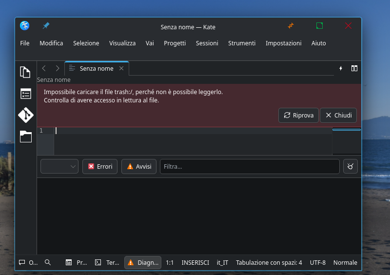

OM ROME Plasma 6
This is what happens when trying to open trash by taskbar.
It seems I’ve lost permission to access file.
Can you help me to change permission to the trash file, please ?

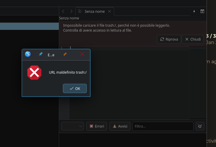

Infact, if I try opening the trash on the taskbar, it is opened by kate. So that’s why it gives problems.
When I open it by Dolphin, no problems arise.
I tried also to delete the widget and add again to the taskbar, but it is always opened by kate.

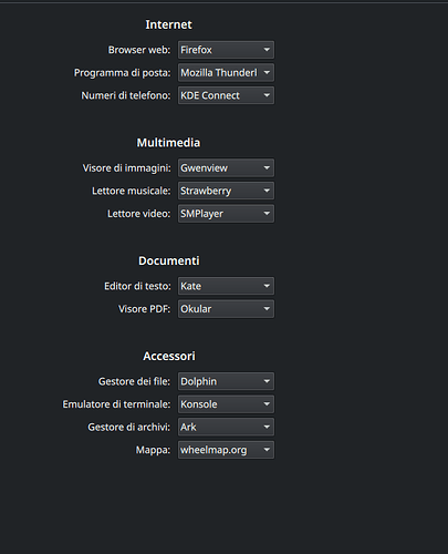

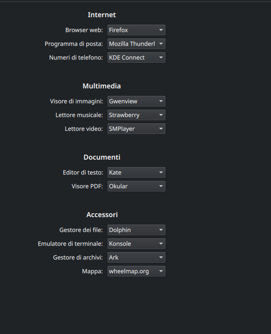

Normally the recycle bin should be opened via the default file-manager of your desktop, in my case the DE is LxQT and the file-manager pcmanfm-qt, if you use plasma, usually the default file-manager is Dolphin, so the widget on the desktop should not open with Kate (which is an advanced text editor) so: in the Plasma settings, “Default Applications” section, you should check which application is set up and change it if necessary.
It was the default manager set to kate. Maybe, by mistake, I restored defaults (that is Kate, don’t know why).
I changed to Dolphin, and it seems all OK.
Thank you all for your support.
