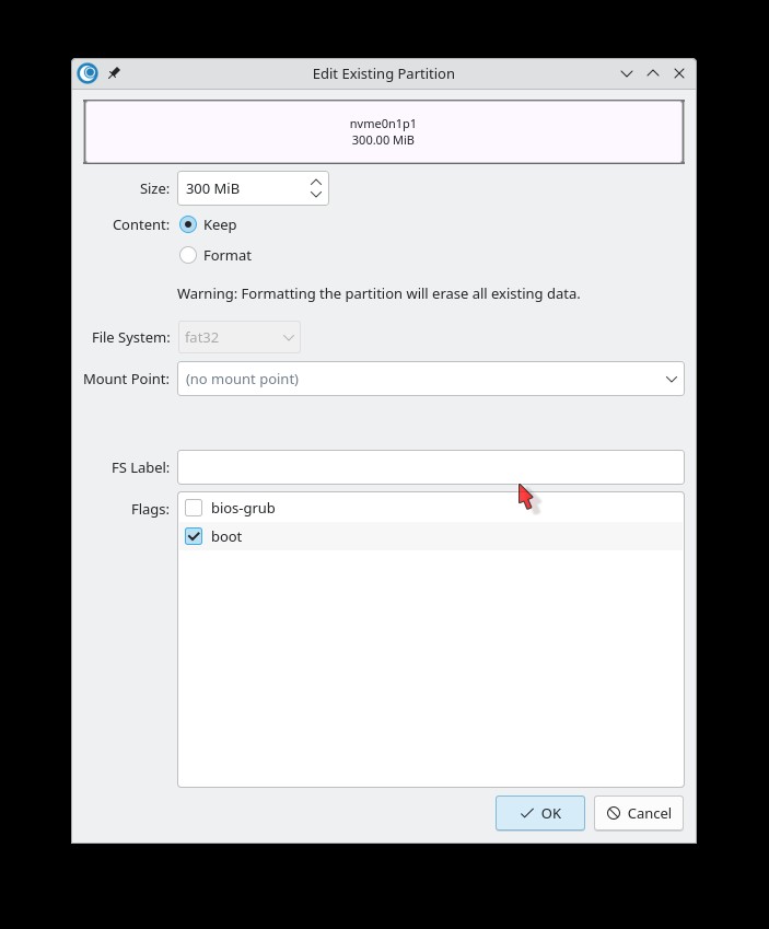

No mount point was set for EFI System Partition. In the partitioner you have to use manual partitioning and set a mount point for the EFI System Partition. That would be seen in this line:
mountPoint: : ""
Should be:
mountPoint: : "/boot/efi"

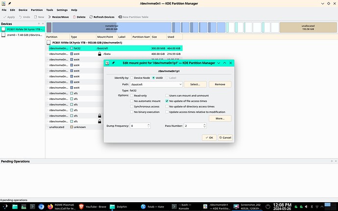

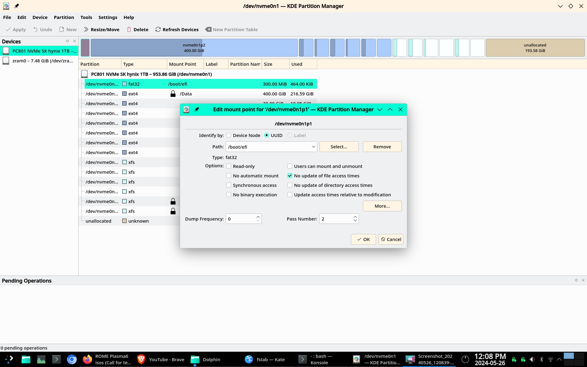

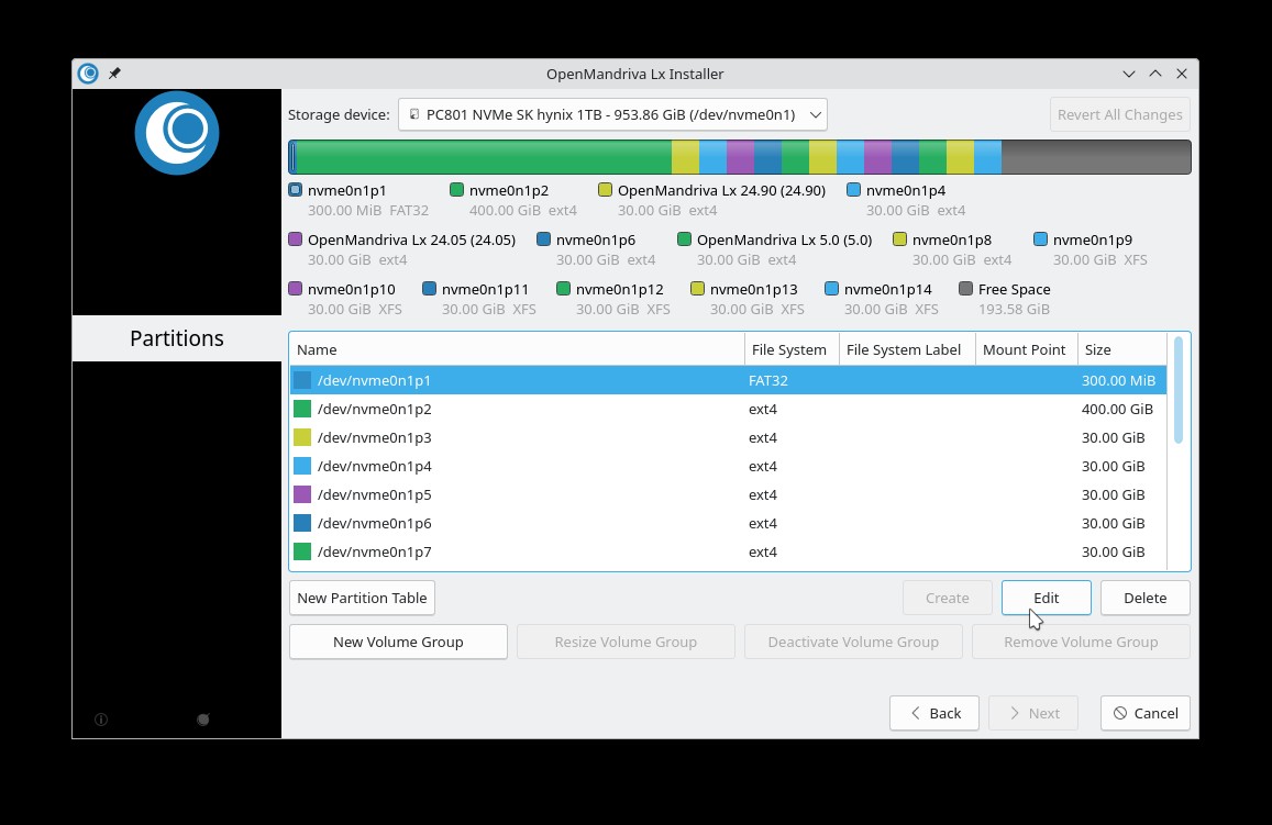

Or I think you could just open KDE Partition Manager and select the /boot/efi partition and add the mount point in “Path”:
That should add the entry correctly to /etc/fstab and then:
sudo update-grub2
sudo grub2-install /dev/sda

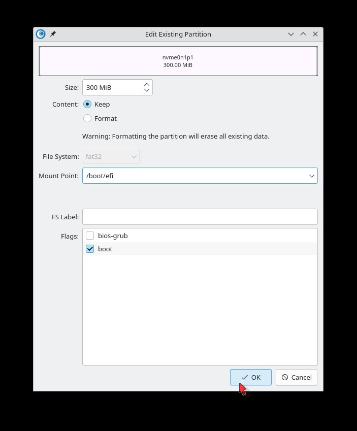

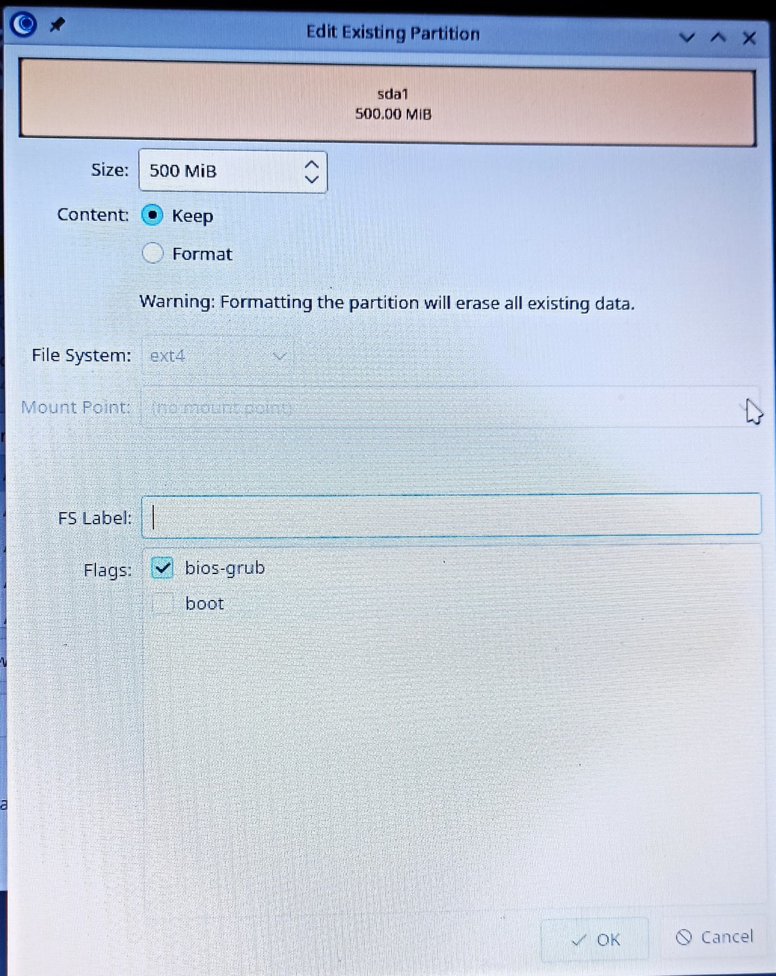

Well. I didn’t set the mount point in my boot/efi partition, because the option in the panel is not available…

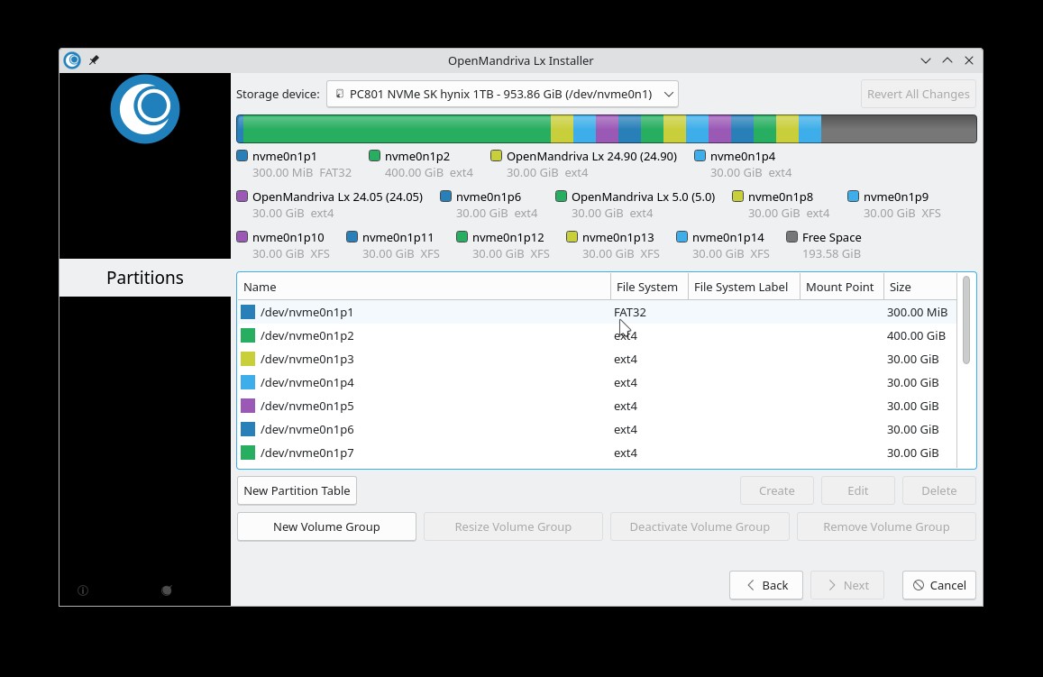

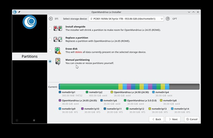

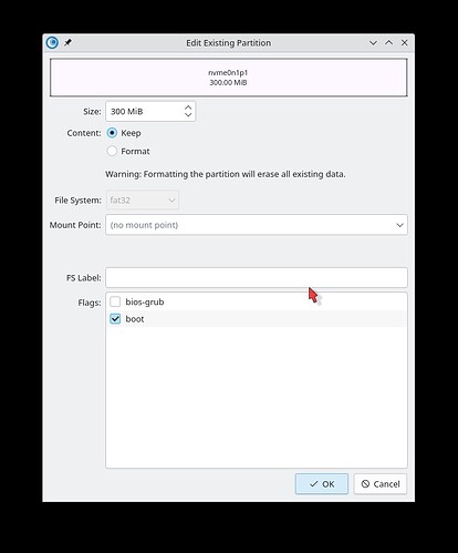

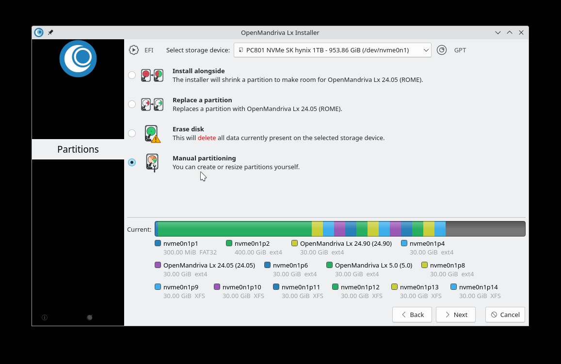

That is the wrong place. That is “Replace a partition” you need to use “Manual Partitioning”.
Note that the boot flag must be enabled not the bios-grub flag.
IMO the “Replace a partition” should recognize the /boot/efi partition and deal with it correctly but it does not. It has been a long time since I looked in to this but as I recall this is an upstream issue. “Manual Partitioning” works, I use it a lot especially recently with testing all the new Plasma6 and LXQt isos on my laptop. On my laptop I have to use Manual Partitioning it is the only thing that works on a multi-boot UEFI box.

No — Sostituire una partizione
Sì — Partizionamento manuale
