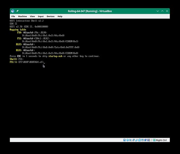

The latest ISO’s build 396 and 397 installed in VBox. Also checked that they boot Legacy and UEFI on hardware.
In VirtualBox EFI boots to uefi interactive shell but they boot if you know how to use the shell. Note: Once you install the Cooker system it will boot normally this only applies to running the ISO media.
Cooker/Lx 4.3 ISO’s EFI boot to shell in VirtualBox bug report
system-config-printer is not working. system-config-printer works not bug report.
Otherwise things seem to be MOGA. (Make OpenMandriva Great Again!)
This applies to current all Cooker/Rolling/OM Lx 4.3 ISO’s. Also it applies specifically to OM’s own virtualbox-6.1.26-1. As I recall the issue will be the same in Oracle VirtualBox.
The workaround to boot OM Lx ISO’s in VirtualBox from uefi interactive shell:
  1. At the prompt type FS1: and hit enter
  2. At the prompt type EFI\BOOT\BOOTX64.efi and hit enter (Note: those are backward slash not forward slash, it matters)
Screen-shot of the procedure:
Result:
Hint: If you were trying to Legacy boot and got the uefi interactive shell you want to type FS0: to get to the files for that.

This is fixed now.

Looks like new ISO from 16.11 is broken at least for me. Just never ending black screen at boot process. Tested in VB and Boxes. Can anyone confirm or deny?
@AngryPenguin I checked the ISOs from 16.11 (#'s 481, 480, 477 and 478) and found they boot Legacy or UEFI on my desktop (Ryzen5 3600) with no problem In VirtualBox they boot Legacy OK. If user wishes to use EFI boot in VBox they boot to an interactive shell where you enter a few commands to EFI boot as described here. After EFI install in VBox then the installed system boots normally.
