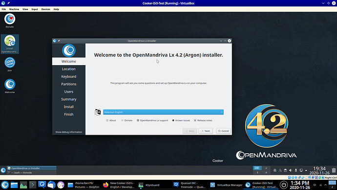

  1. Both ISO’s booted with EFI enabled, and installed in VirtualBox.

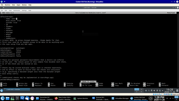

There was a bug user might needs to know about to install from older ISO’s. ISO’s from # 3598 to 3609 were affected by this.
If you try to open Calamares you will see:
You will need to edit /etc/calamares/modules/users.conf. You want to change the 3rd line from:
- users
To:
- name: users
So it looks like this:
And now you should see this when you open Calamares:
