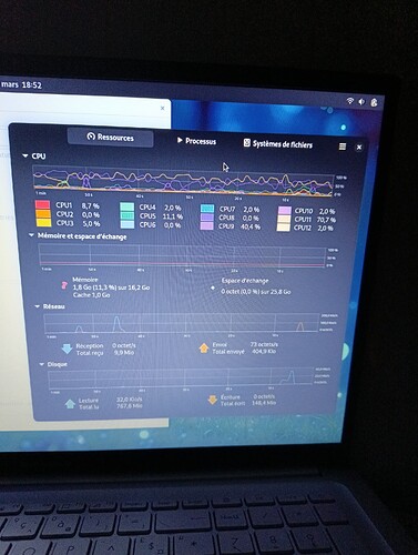

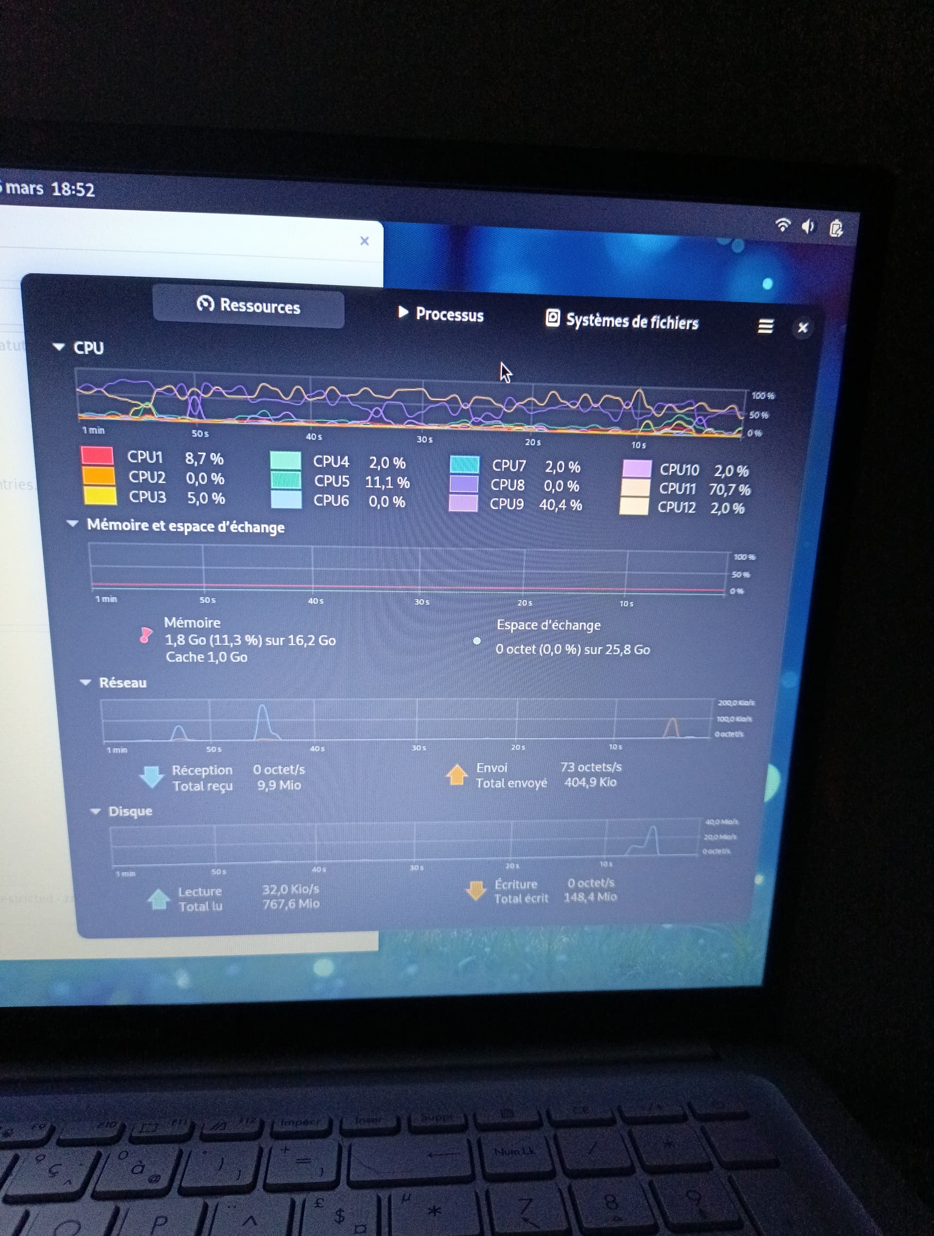

(with OM Rome Gnome znver1)
I had a processor overrun, which I can’t explain.
After about ten minutes, the CPU fans went into overdrive, the system monitor integrated into gnome told me everything was fine, I launched the system monitor and there on 12 threads, 10 normal and the last 2 at 100% load alternately.
As this is my main computer, I can’t investigate it (stability needed).
@ben79 I fact, at the beginning, Lezigue was looking for the AMD microcode package and i recommanded him to install the znver1 iso version. Maybe my recommandation was wrong and it will be better for him to install kernel-firmware-extra first :grimacing:

J’ai réinstallé la distribution et s’est vrai que pendant 20 minutes le processeur se met en route et après se stabilise
