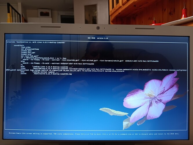

Are you suggesting to install the nouveau driver and boot with nouveau.config=NvGspRm=1
I think i know how to edit the grub boot but where do i add this line? also do i need to add to default grub and update to make it permanent? Is this likely inhibit 3D modeling with freecad.
Maybe i need to just suck it and see, if all else fails i can stick with gnome until this is fixed or the cinnamon desktop works.
That is a nvidia only option.
From the boot menu, you can edit the lines in the Advanced section (letter E). Then you add the setting after the other nvidia settings. I think you then hit F10 to boot, but the screen will tell you. It will not make the change permanent, just for that boot up.
You can try it, but I wouldn’t expect much.
Ok i will give that a go and report back.

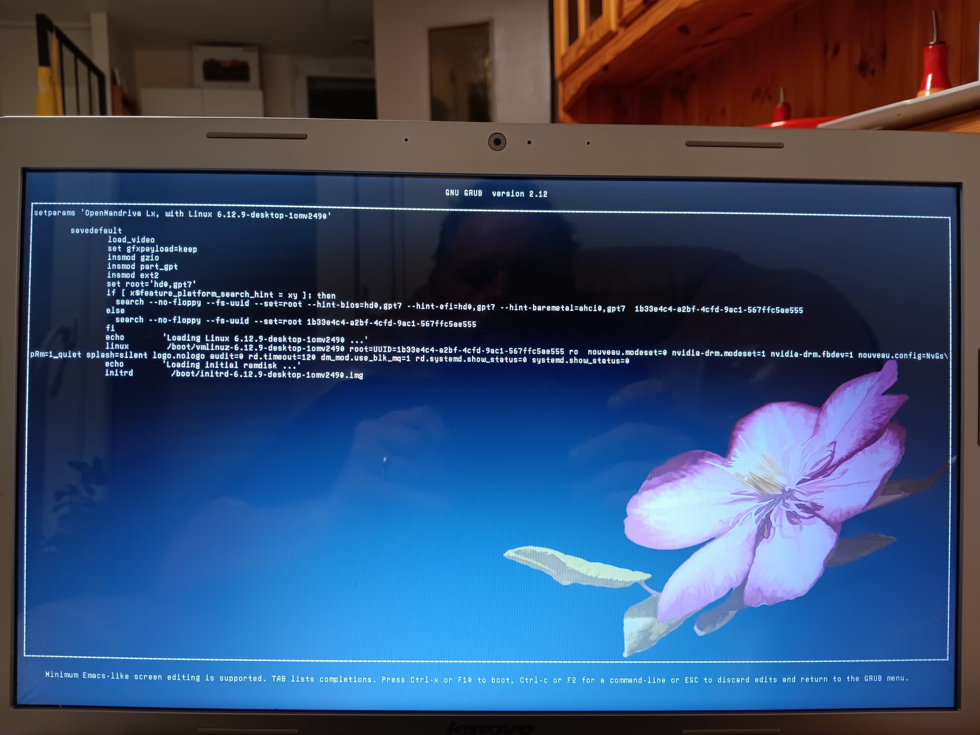

I tried adding the kernel peramaters, it didnt solve the lid reopening problem but logging in took longer than usual
the under score before quiet splash is just the curser i didnt think to move it after typing.
Its not a huge problem i just need to avoid closing the lid whilst logged in for the time being. Thanks again.

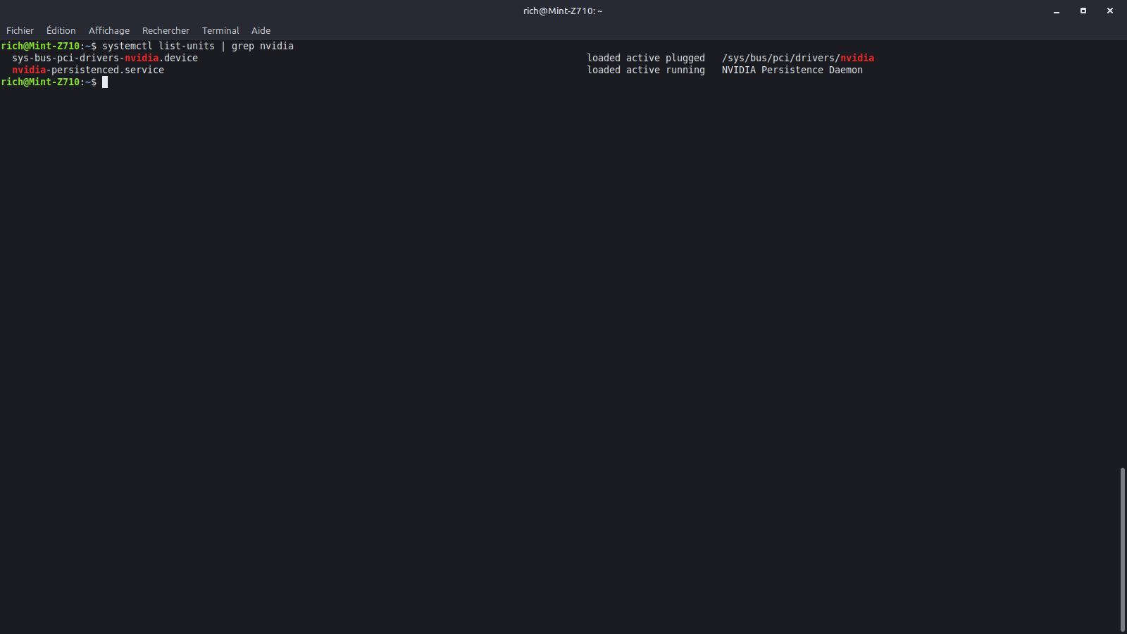

I then tried
systemctl list-units | grep nvidia
this produced no results however i checked the same thing on my linuxmint install and got this
I know linux mint is not OM but didn’t know if this info would be useful.
