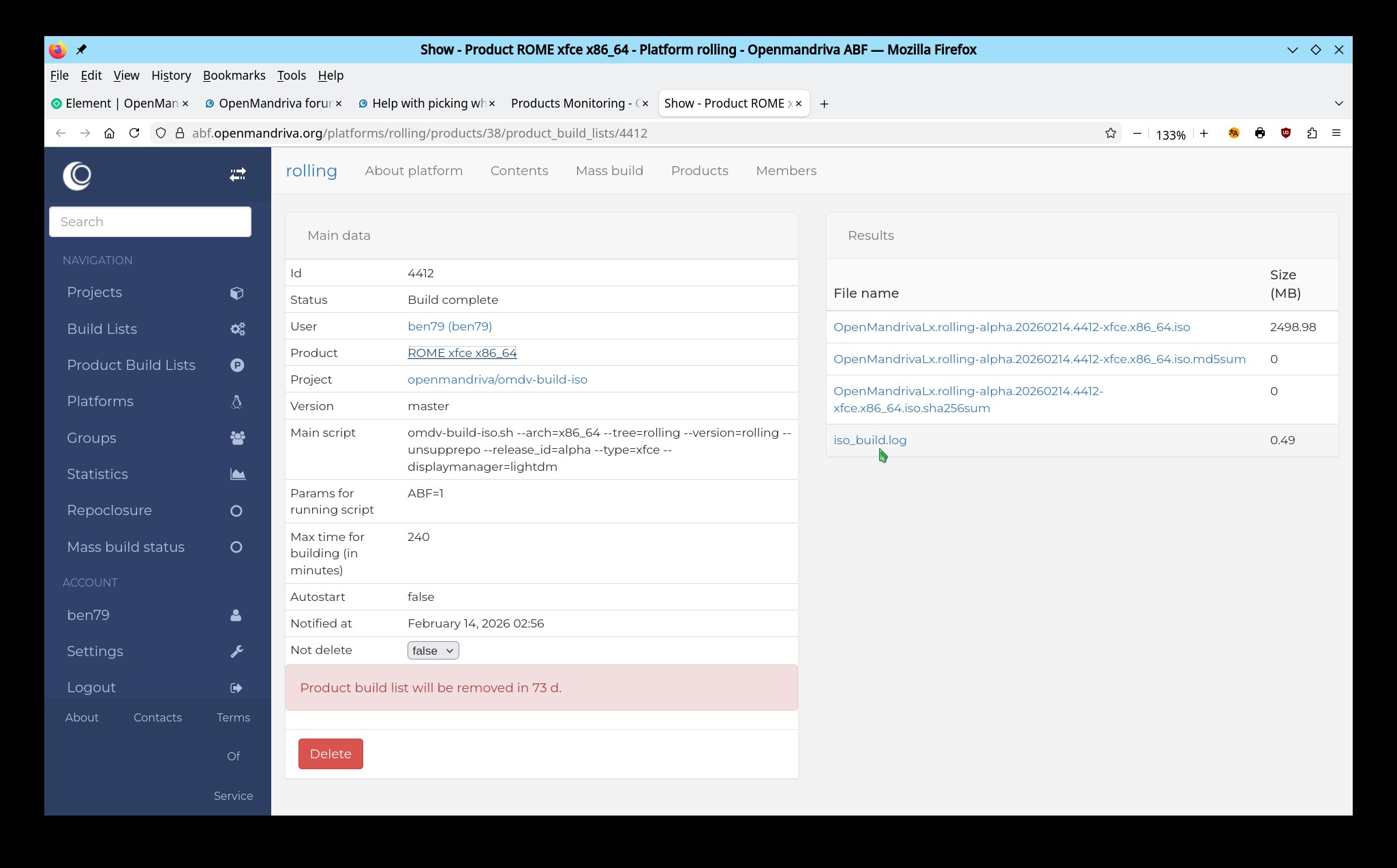

Look at the iso_build.log for the iso you are using.
All versions of OMLx beyond Plasma6 and Gnome are experimental, meaning they are alpha or beta. To fix problems with any of them you need to engage with the maintainer of that version, if there is a maintainer. That is a lot more likely to happen on OM-Chat than in this forum but you never know. Even with Gnome if you have problems you need to be talking with @AngryPenguin. I do not know who does XFCE.
