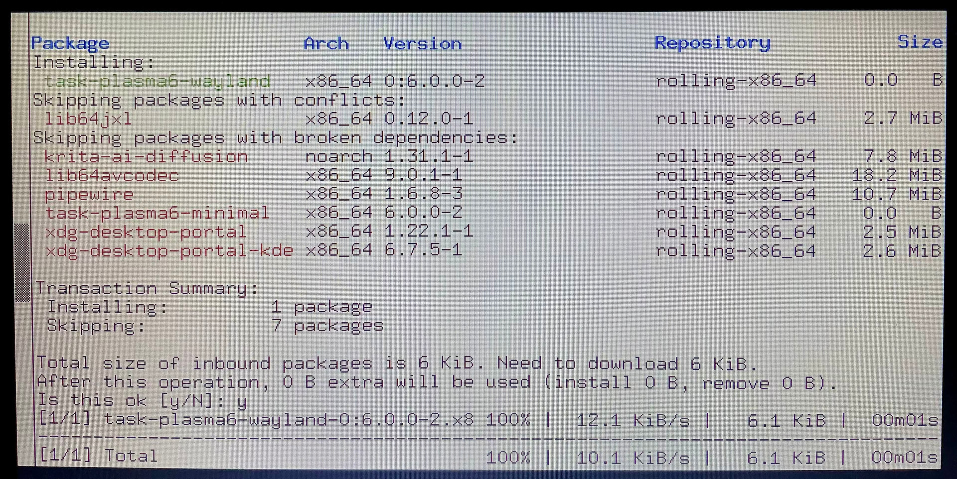

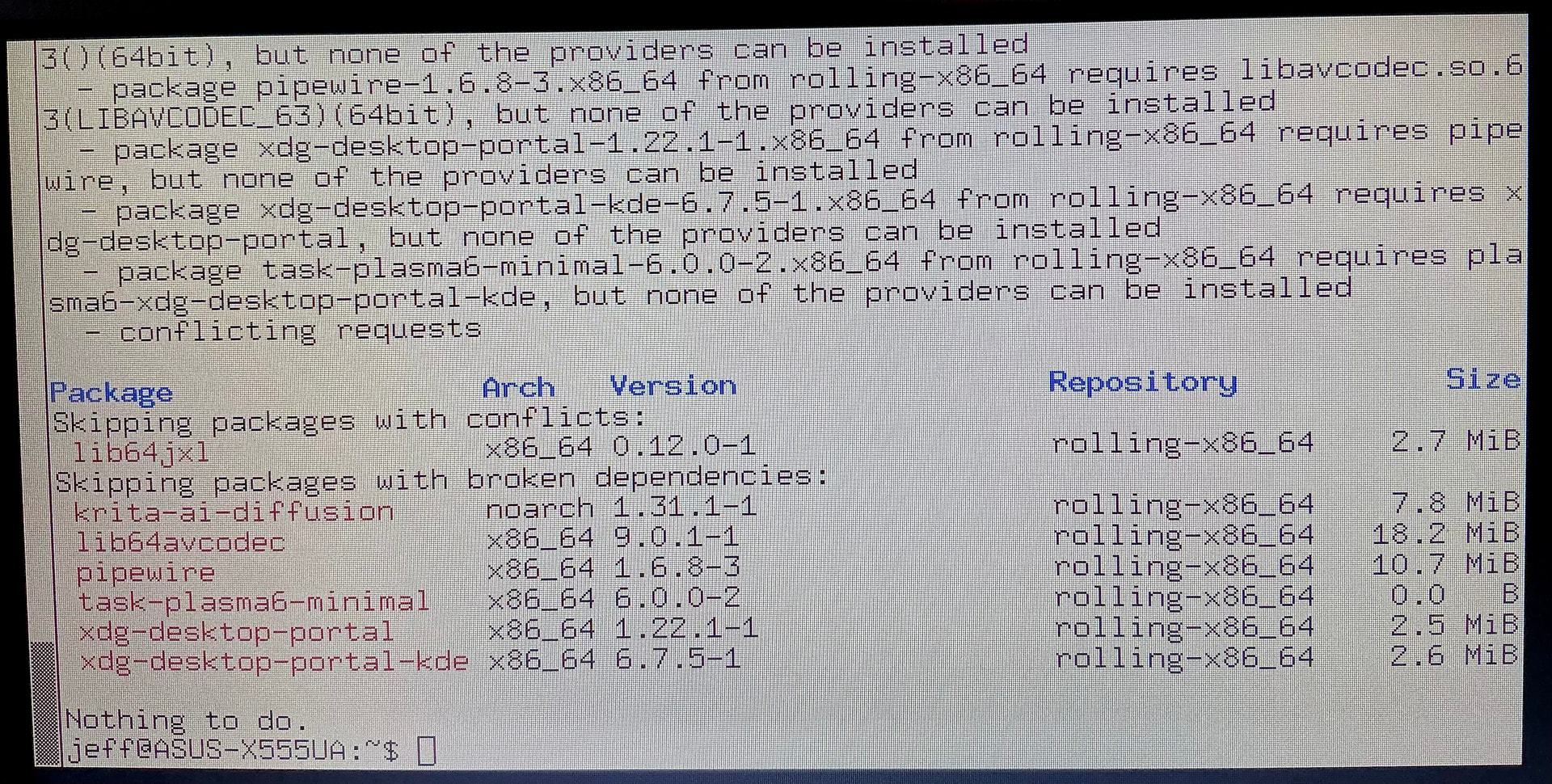

When I try to reinstall task-plasma6-minimal task-plasma6-x11 and task-plasma6-wayland, I am informed that krita-ai-diffusion, lib64avcodec, pipewire, task-plasma6-minimal, xdg-desktop-portal, and xdg-desktop-portal-kde, have broken dependencies. The package with conflicts is lib64jxl. Apparently without them, nothing works in Plasma6. This would explain the lack of sound and no Plasma desktop.

I get the impression that the repositories are down or corrupted.
Try:
sudo dnf remove task-plasma6-* ; sudo dnf in task-plasma-minimal task-plasma-wayland task-plasma-x11
There is no need to use “plasma6”.
If that doesn’t work, do the following at your own risk as this will upgrade you to the latest version of Rome which has not been released yet (I am running it without any real issues).
sudo dnf clean all ; sudo dnf dsync --allowerasing 2>&1| tee dsync-log.txt
You may need to re-run:

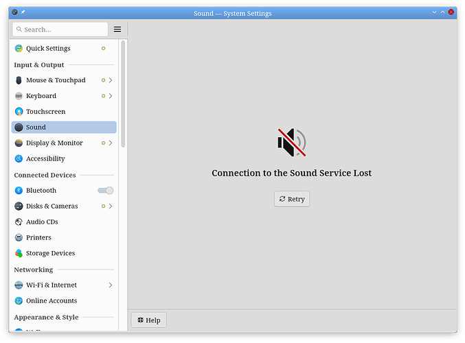

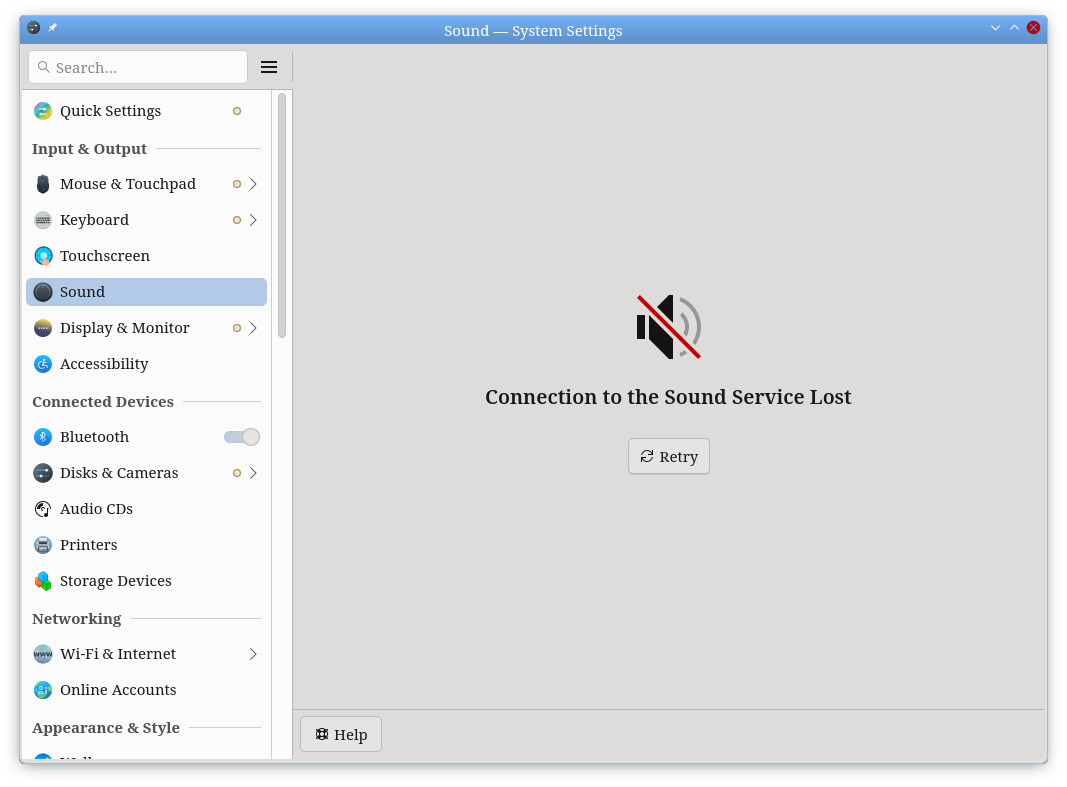

However, there is still no sound from the speakers, with the speaker icon crossed out. “Connection to the Sound Service Lost” is what the dialog box informs. Clicking on retry solves nothing. Same message in System Settings – Sound. I tested it with several media players such as QMPlay2 which says it can’t open the audio stream. VLC does this:
Audio output failed:
The audio device “default” could not be used:
Connection refused.
While the video continues to play as if nothing is wrong.
Over in the browsers, no audio coming from any of them, Brave Origin, Vivaldi Stable, and Zen.
While testing, Haruna and MPV media players have no problem with audio.
Same results over on the TDE desktop.
Any ideas why sound would work for some and not others?

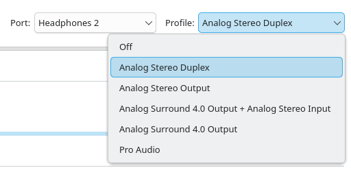

In KDE System Settings > Sound, check that you are using the right PORT and PROFILE. They have drop-downs to change them.
This is what I have, now that I can do actual screenshots again:
It was getting late last night and I didn’t think hard enough to do a screenshot. Therefore, I was not clear enough.
Over on the TDE desktop, I do have sound output settings, however, those settings have no effect on the results. No audio from VLC, QMPlay2, and the browsers while Haruna and MPV will output sound.
