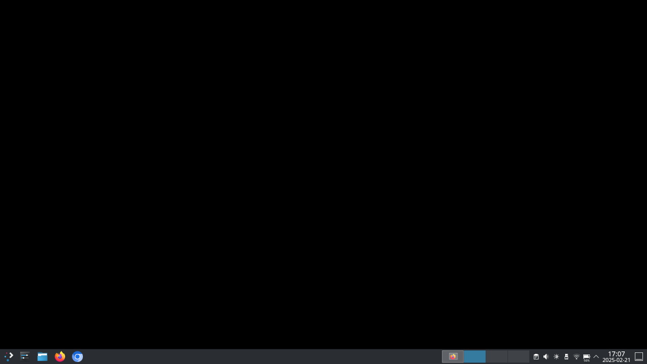

    Sometimes, when I power on the computer the desktop doesn’t seem to load. This means there’s only a black background with none of my icons available. Right-click doesn’t bring up the context menu, either.
    The panel loads normally and I can do everything I need to do without issue. The files themselves still exist and can be accessed with the file manager, but things like dragging files from/to the desktop won’t work.
    For context, my laptop has a faulty screen and one of the first things that I do is disable the built-in monitor and rely solely on an external display. I can solve this problem by going into the settings to enable the builtin screen, and then just disable it again. So, easy enough, but it would be nice to not have to do this when this happens.
    I should also mention that the built-in screen on the laptop stays on up until I login to my account. The background at that point still works fine and I see the wallpaper, it’s just right after I press enter to login that things seem to break.

Hi, thank you, I just turned on the computer and happened again:
These commands worked, and everything is fine again! It’s definitely easier than going through the settings, but of course I’ll have to remember it for next time… I’ll write it down somewhere.
