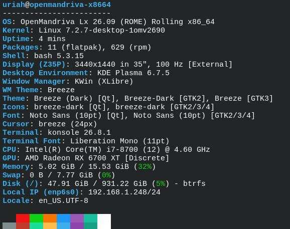

Hey I tried this out and it is not working for me. The installer will open but locks up with this error when I click on the flatpack tab. The updater fail to launch at all.
If you want me to try anything to help fix this let me know

I’ll have a look at the installer error. The updater should work fine; it doesn’t appear until after it’s checked to see if updates are available, so it can show the right icon.
